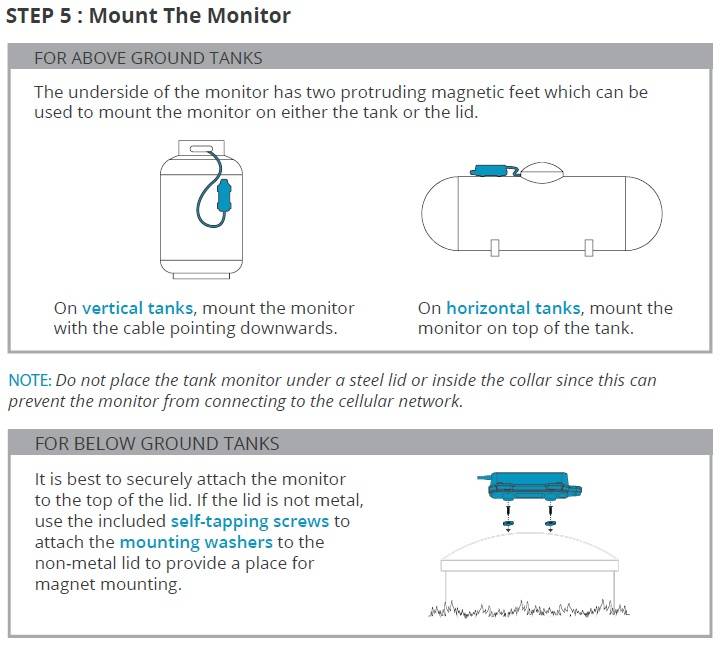

jrmichler said:
Is this LP gas? In theory, an ultrasonic sensor mounted externally should work.
Since I use propane as a heating source, I got curious about this. I did a little searching and found this site showing Generac makes a top of tank Wi-Fi level monitor. Here's a screen-shot from the installation .pdf file:
Thank you folks for your reactions...
- jrmichler - yes, LP gas. More specifically, Butane tank of 20, 30, ... KG. I'll look at Adafruit sensors.
- Tom.G - Strip, I saw that Technic but I prefer to explore different and more sophisticated ways. I looked in the past to load cell approach, but It may not fit as requires more logistics to consider, compared to light sensor way...
-dlgoff - what's the site you are referring to?
