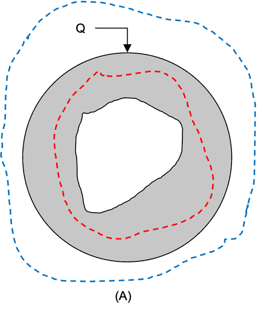

In figure (A) on the right is shown a conducting sphere with an irregular cavity inside it. Total charge ##Q## is placed on the sphere. Where does it go?
Answer: Consider two Gaussian surfaces indicated by dashed lines, blue enclosing the sphere and red enclosing the cavity. Since the electric field is zero everywhere inside the conductor, it is also zero everywhere on the red surface. By Gauss's law the total charge enclosed by the red surface must be zero. It follows that charge ##Q## can only be on the surface of the sphere. If not, you should be able to find a red Gaussian surface that will enclose some charge which will make the field inside the conductor non-zero.
The blue Gaussian surface encloses total charge ##Q##. Because the spherical surface symmetry, it will be distributed uniformly over the surface and the electric field outside the sphere at distance ##r## from the center will be the same as if total charge ##Q## were concentrated at the center of the sphere, $$E=\frac{Q}{4\pi\epsilon_0 r^2}.$$Of course, the field is not the same everywhere on the blue surface, but at any point on it, it will be given by the above expression.
