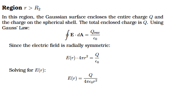

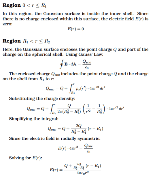

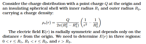

Hi
I'm trying to solve this
So far I have got
But me not sure whether it correct or not. Maybe someone knows of a way you can check answer is correct like in math when you plug solution to solve equation?

In the first region ##0 \leq r \leq R_1## the electric field is not zero. The problem clearly states that there is point charge ##Q## at the origin.
Also, in the region ##r>R_2## you need to do the integral to find the total charge on the sphere. That, plus the charge at the origin should give you the enclosed charge.
