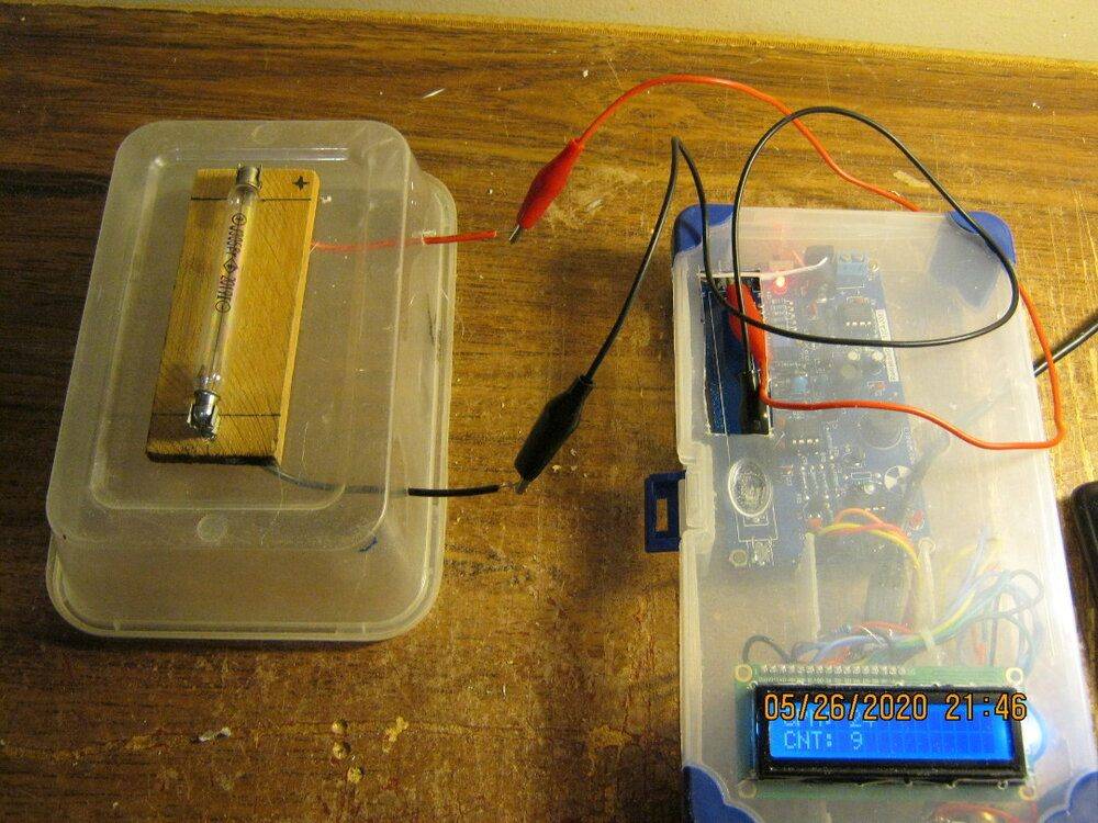

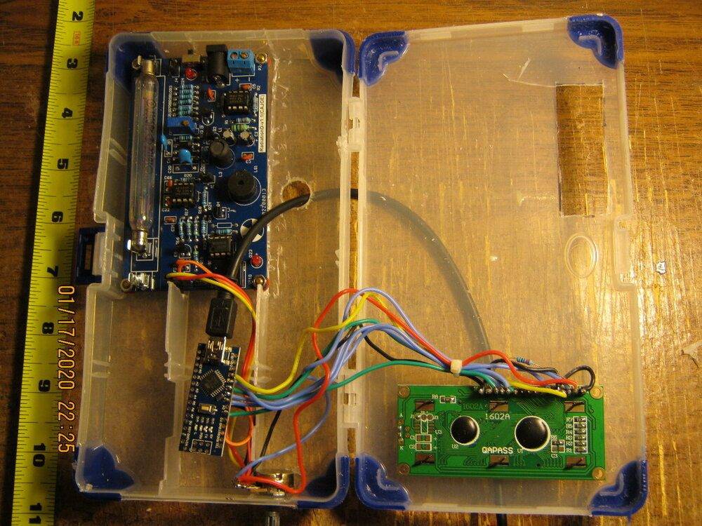

I purchased a RadiationD-v1.1(Cajoe) geiger counter off ebay, and attached an arduino nano and a 16x2 display ( I got the instructions off this site https://www.instructables.com/id/Arduino-DIY-Geiger-Counter/). I noticed that the counter was sensitive to UV when I had it out in the sunlight, so I decided to expose it to several UV sources.

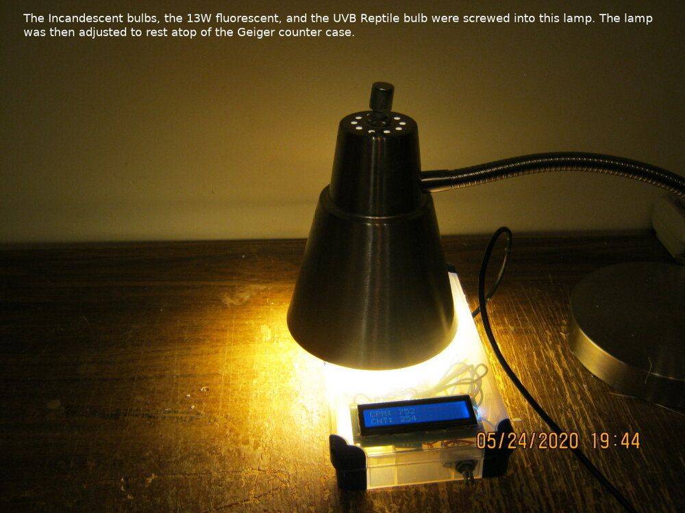

Incandescent Light Bulb (Frosted Soft White 60 Watt Globe 130 Volt BB 0903)
1st minute 39 counts
2nd minute 35 counts
3rd minute 40 counts
4th minute 29 counts
Incandescent Light Bulb (Frosted Phillips Duramax 60W/120V China 1F)
1st minute 317 counts
2nd minute 203 counts
3rd minute 104 counts
4th minute 112 counts
5th minute 48 counts
6th minute 27 counts

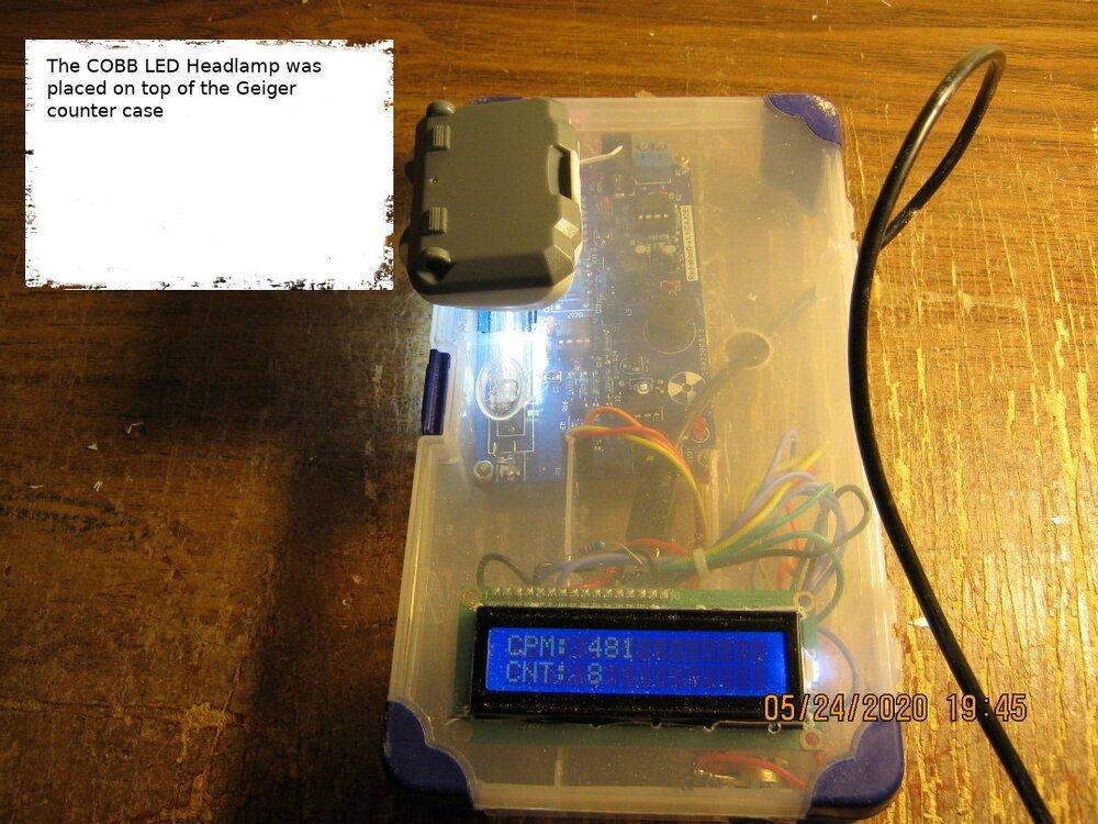

COBB Led Head Lamp – Average 61.7 counts per minute
Fluorescent 13W mini twister Phillips – Average 940 counts per minute

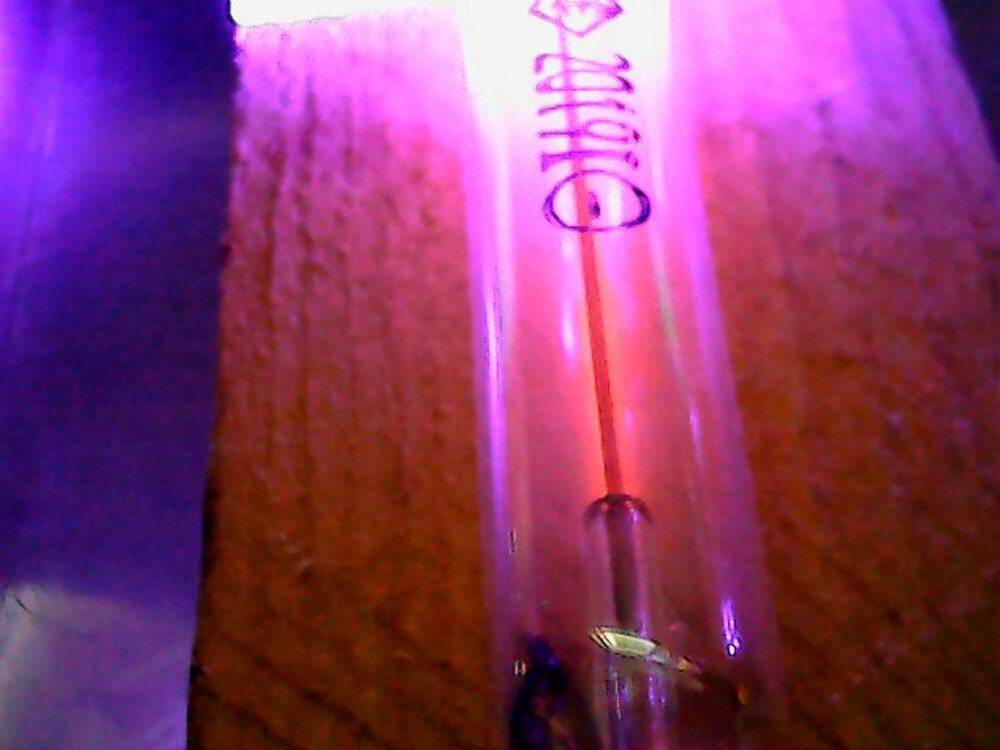

405nm Laser Pointer – 106385 counts per minute the laser pointer was aimed at the point where the anode enters the glass envelope (Green and Red laser pointers had no effect)

UVB Reptile bulb 13W fluorescent – Average 622211 counts per minute

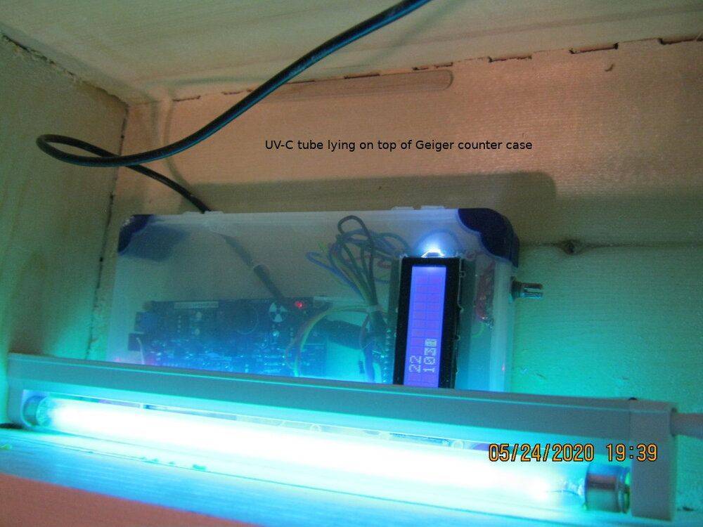

UVC germicidal tube – got one count of 10314 and then the screen scrambled. The Geiger counter had to be restarted. The screen would start garbling, but the counter would still beep. This was done in a closed wooden box to reduce the exposure to UVC.
What could be done to prevent the screen from scrambling when measuring UVC? Would shielding work? Or should I increase the distance between the UVC tube and the counter?

Could you post a picture of your GM counter just as you exposed it to the light sources?

When the counter display became garbled when it was exposed to the UVC lamp, it might have been due to overheating. The counter had been running for an hour or two with light sources right up against the case.
I was using a cheap battery powered cell phone charger to supply the five volts to power the counter. I will use a USB hub instead
You might try covering the electronics to shield it from the light. Cardboard and masking tape would do, I think. Semiconductor junctions are sensitive to photons and components that have clear plastic, like LEDs and some diodes might cause problems. OTOH, if everything looks like its black plastic or metal, this is probably a waste of time.
Why not have the GM tube remote from the electronics? The electronics could be in a metal box and left for a while to arrive at a stable temperature.

Putting UV light on the tube will not scramble the screen. This is almost certainly due to EMI from the tube.

I separated the GM from the rest of the board
I exposed the separated GM tube to a incandescent bulb (Phillips Duramax 60W) and the average count was 98.4 beeps per minute. I put a welding glass filter (shade #12) between the GM and the incandescent bulb. The count was similar to background radiation. The welding glass filter cracked after 5 minutes. I didn't realize how much heat those incandescent bulbs emit. So I decided to use a blow drier on the GM tube while the tube was in a wooden box recording background radiation. I measured the temperature using a cheap IR thermometer

If the UV is entering the tube ( quartz glass )( you shone the laser at the anode end ) and ejecting electrons from the metal rod, this, I would tend to think not be recorded as a click.

Upon writing that above, would it be possible that the UV ( IS ) entering the geiger tube is kicking electrons off the cathode ( there should be a thin wire visible surrounding the interior anode wire - for the OP to look at ), rendering the tube to act somewhere within the cold cathode regime without discharge, up to the point of the scrambling when complete ionization and plasma occurs to overload the circuitry.

The J305 Geiger tube was removed from the Geiger counter and placed in its separate holder. A USB ionizer was used to power it. The USB coupling was removed from the ionizer, and 3 AA batteries in series were hooked up as the power source (no counter attached). The USB ionizer consists of an oscillator, a step up transformer, and two diode capacitor voltage doublers. There is about 420 V of potential between the voltage doublers and ground. The normal operating voltage for the tube is 380 to 450 volts. The tube started to get a red glow when a 405nm laser pointer was directed at the anode. A thorium gas mantle produced sporadic red glows. When I try to read the voltage across the tube when it is installed in the geiger counter the counter starts squealing and the display starts to scramble (240V). Has anyone else been able to get a J305 tube (or any other glass Geiger tube) to do this? I couldn’t use a digital multimeter for the measurements because the reading would constantly change.

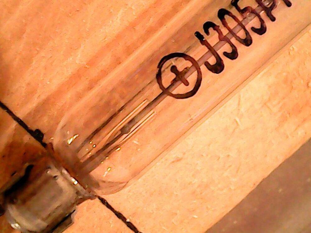

I think what you have proven is that the J305 is photo-sensitive.
Solution?: Block light getting to it
Method: Try some Aquadag coating on the outside of the tube. It is colloidal Graphite so keep it away from the electrical contacts.
