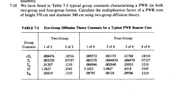

Up scattering isn't an issue , I am more concerned with the direct coupling thing also This is the question I have 2 thermal groups and 2 fast, I have to collapse the 2 fast groups with one of the thermal into one group ? so 3 groups into one ? I am trying to derive an expression for segma absorption but the fluxes of 1 2 and 3 are extremely hard to play around with .
  • Table 7-2 of few-group diffusion theory constants for a typical PWR reactor core, with two-group and four-group columns listing cross sections, D and removal values.
You have to have the group fluxes in order to collapse. You need the group fluxes to preserve the reaction rates.
The equation I gave is correct, but the upscatter cross section may be zero. I gave you the general form. Just set the upscatter cross section to zero if it is zero.

Looking at the question from the book, you are not given enough information to collapse the cross sections yourself. It isn't even clear if the thermal group includes two or three of the groups from the 4-group table. The cross sections are just given to you in this problem.
Why are you trying to collapse them? If you do want to collapse them, you will have to solve a problem with 4 groups and then use the flux spectrum to collapse down to 2 groups. It would help if you had the group boundaries so you know which groups to collapse to.

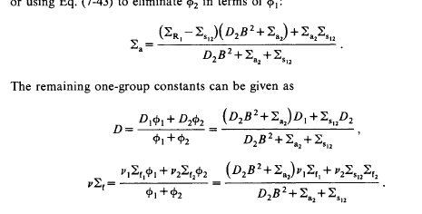

Thank you for the replying, Question is about collapsing the first 3 groups noticing that the third one is a thermal one and the first two are fast.
I have to derive a general expression for collapsing N groups like this one :
  • Printed textbook page with equations for a nuclear group-collapsing expression: Sigma_a as a fraction over D2B2 plus sigma terms, and one-group constants D and nu-Sigma_f written as ratios of two-group weighted sums divided by phi1 plus phi2.
We are slowly getting there...
In order to collapse cross sections, you need a neutron flux. In the example you gave in the last comment, the flux came from the analytic solution for the following situation:

Now, to collapse cross sections, you need to flux weight them. To collapse 2-groups to one-group
\overline{ \Sigma_a }= \frac{\Sigma_{a1} \phi_1 + \Sigma_{a2}\phi_2}{\phi_1 + \phi_2}
If you use the 2nd diffusion equation to solve for ##\phi_1## and substitute it into the collapse equation, you will get
\overline{ \Sigma_a }= \frac{\Sigma_{a1} (D_2 B^2 + \Sigma_{a2}) + \Sigma_{a2} \Sigma_{21} }{ D_2 B^2 + \Sigma_{a2} + \Sigma_{21} }
Which is equivalent to what you showed. All of the flux terms cancel, and the average cross section is just an expression with cross sections.
So what you need to do:
1. Come up with an analytic solution to the 4-group equations, which will include approximations for ##\chi## and the downscatter cross sections
2. Insert the resulting flux values into the collapse equations.

The question is all about deriving an equation similar to the one you mentioned but for N-groups. the other equation is collapsing the first 3 groups into one group noticing that the first two groups are fast groups . about the spectrum the fact that X1+X2=1 may help the thing is about K I have to end up with an equation that doesn't have K . Book I am using is Nuclear reactor Analysis "James Duderstadt"
