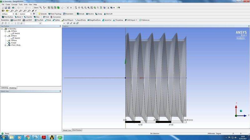

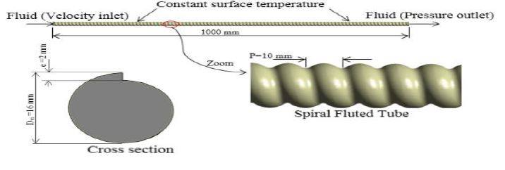

I am trying to make a spirally fluted pipe in ANSYS. I made the cross section as in the attached figure and sweeped on a straight line perpendicular to plane of the cross section. However I get a sort of a drill bit instead of the required spirally fluted pipe. Is there an issue with the cross section or the way I sweep ? Also is there in blog/forum for help on ANSYS issues. Thank you very much in advance
You cross section has a sharp step in it. That looks wrong to me.
Likes Nidum
That shape can be generated in several ways but one way is to draw a cross section of one half trough + one full lobe + one half trough and then rotate and translate .
Merge the join line and trim the ends flat to complete .
Try a cross section similar to the valve cam on a car?
