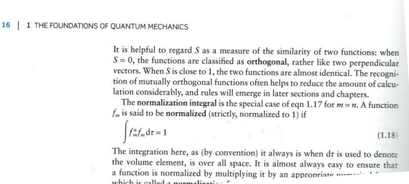

Maybe I misunderstand. The overlap integral of the wavefunction and its complex conjugate :\begin{equation}
S= \int_{-\infty}^{\infty} \psi \psi^{*}dx
\end{equation}
yields a non-zero value for S, for the infinite domain.'
This categorizes Psi as non-orthogonal. That is why I call it non-orthogonal.
Thanks
SeM said:
\begin{equation}
\end{equation}
No - it gives the length squared of psi considered as a member of a Hilbert space. You divide by root S to get a normalized psi, which is what you normally work with in QM because it allows you to directly use the Born Rule. The integral you gave from x1 to x2 then gives the probability of the particle, when observed, being found from x1 to x2. That's the precise reason the function you posted at the start is pathological in QM - it is non zero out to infinity - it not normalizeable and the Born rule will not work. You can transform it with a Fourier transform so psi now is in momentum space. You do that and you get the Dirac delta function at 1. Its not strictly normalizeable either (but being loose in use of squaring such a function, which actually is a rather advanced topic - it can't be done in distribution theory - but most applied mathematicians don't worry about it and just naively do it - you can try - I will explain later) but in probability theory it represents a probability of momentum 1 with a dead cert. Its one of the uses, applied math wise, of Distribution Theory, how one handles discreet probabilities like that of a dice in continuous probability functions:
