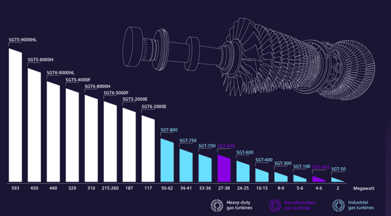

What power level is your prototype targeting? Is 100,000 RPM typical for gas turbine power generators?
https://www.siemens-energy.com/glob...QEfrmElUVeIS4UvNrDpBTvWjKnLD9iphoCKyEQAvD_BwE
the maths says about 6 hp at 30,000 rpm which is my benchmark for calling it successful. Using diametrically opposed permanent magnet rotating on the shaft increases the safety as it should not want to fail at high rpm due to centrifugal force. I’m just asking if one coil can be wound around the rotating magnet or is two coils still required. Being homemade and with lots of engineers saying that it can’t be made anything I can do to improve the efficiency is worthwhile. Setting the distance with two coils increases the chances of errors where as one coil wound around a mould and tightly fitted into a machined housing limits the possibility of errors in output. Using one coil I can achieve a 1mm gap between coil and magnet. I don’t think I can achieve that tight of gap fitting two coils.
Large gas turbines don’t run near as fast and have professional gearing available to access shaft power. I have built a turbo based jet engine and even using a freepower turbine to turn thrust into shaft hp it is still 30,000. My prototype is small But the higher the rpm the higher the output. Limited by materials I’m setting the design around 30,000 and 6 hp. There is potential to increase rpm after proof of concept.
