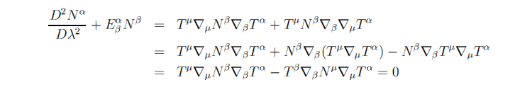

Taken from my lecturer's notes on GR:
Handwritten-style typeset derivation of the geodesic deviation equation: D squared N alpha over D lambda squared plus E beta alpha N beta equals T mu nabla mu N beta nabla beta T alpha plus T mu N beta nabla beta nabla mu T alpha, then rewritten and concluding equal to zero.
I'm trying to understand what goes on from 2nd to 3rd line:
[tex]N^\beta \nabla_\beta (T^\mu \nabla_\mu T^\alpha) - N^\beta \nabla_\beta T^\mu \nabla_\mu T^\alpha = -T^\beta \nabla_\beta N^\mu \nabla_\mu T^\alpha[/tex]
Using commutator relation ## T^v \nabla_v N^\alpha = N^v\nabla_v T^\alpha ## we swap the 'N' for the 'T' in the last term of the second line:
[tex]N^\beta \nabla_\beta (T^\mu \nabla_\mu T^\alpha) - T^\beta \nabla_\beta N^\mu \nabla_\mu T^\alpha = -T^\beta \nabla_\beta N^\mu \nabla_\mu T^\alpha[/tex]
[tex]N^\beta \nabla_\beta \left(\frac{D T^\alpha}{D\lambda}\right) - T^\beta \nabla_\beta N^\mu \nabla_\mu T^\alpha = -T^\beta \nabla_\beta N^\mu \nabla_\mu T^\alpha[/tex]This means that ## \nabla_\beta \left(\frac{D T^\alpha}{D\lambda}\right) = 0 ##. Why is this so?

Use the product rule on the second term of the second line.
That would just take me back to the first line.

##T## and ##N## are tangent vectors and normal vectors correspondingly, with ##T## describing movement along a geodesic and ##N## describing movement from one geodesic to another.
I thought the geodesic equation is ##\frac{d^2x^\beta}{d\tau^2} + \Gamma^\beta _{\mu v} \frac{d x^\mu}{d\tau} \frac{d x^v}{d\tau} ##?
I reduced the term in the brackets to ## \nabla_\beta \left(\frac{D T^\alpha}{D\lambda}\right) ##. I'm trying to understand why it is zero.

For a curve on space-time ##x^\alpha = x^\alpha (\lambda)##, we define the absolute derivative of a vector ##V^\mu## along that path to be expression ## \frac{D V^\mu}{D\lambda} = T^\alpha \nabla_\alpha V^\mu ##. For ##V^\mu = T^\mu##, we get ## \frac{D T^\mu}{D\lambda} = T^\alpha \nabla_\alpha T^\mu ##
If the vector ##T^\mu## is parallely transported along the path, ##\frac{D T^\mu}{D\lambda} =0 ##. This is obviously true for the tangent vector ##T^\alpha## ,so ##\frac{D T^\alpha}{D\lambda} =0 ##
Using ## T^\alpha = \frac{dx^\alpha}{d\lambda} ## and expanding, it simply gives the geodesic equation:
[tex]\frac{d^2 x^\alpha}{d \lambda^2} + \Gamma^{\alpha}_{\mu v} \frac{dx^\mu}{d\lambda} \frac{dx^v}{d\lambda} = 0[/tex]
