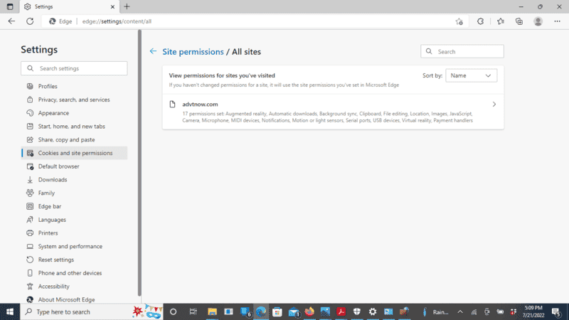

This is the latest I've tried. I gathered the popup was using Microsoft Edge. I had disallowed all popups on the Internet Options menu. But I guess kind of tricky that sets of Options/Permissions may overlap and contradict each other ( like, say, county-level, city-level, state-level, etc ). So I checked Edge Content Permissions, which somehow had given permissions ( I think this was the default )
I went to :
edge://settings/content/notifications:
And blocked all access to the webpage listed in the pop-up: advtnow.com that Edge had given by (default)
all sorts of access:

All you did was disable popups. The malware that was creating them in the first place is likely still functioning and spying on you. Do you have any extensions installed?WWGD said:Now, please all join me in a prayer to the God Computus, so that this is permanently fixed. It's been a full hour ( Edit: 4 hours) without popups so far, compared to once every 5-10 minutes or so. This was proposed by someone else.
Homework Helper
- 7,927
- 13,242
I think I've removed all from Edge. Will double check, though. Edit: If there's something still there , its likely a 0-day, since I've received a clean bill of health from 3 AV programs.Jarvis323 said:All you did was disable popups. The malware that was creating them in the first place is likely still functioning and spying on you. Do you have any extensions installed?
