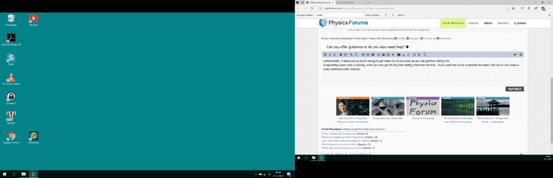

Unfortunately, It takes just as much energy to get water out of your hole as you can get from letting it in.
Evaporating water costs 2.2MJ/kg, while you only get 5KJ/kg from letting it flow into the hole. If you used the sun to evaporate the water, this would only make a really inefficient solar collector.

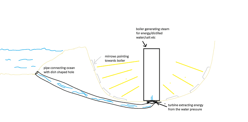

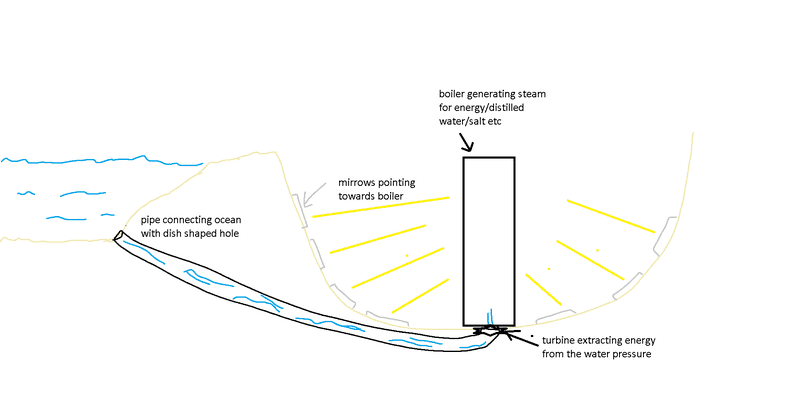

I am not sure you understood my proposal,
The hole in the ground i am proposing would be below water level. As deep as possible technically.
Ideally it would have the shape of a dish, with as many mirrors inside covering it, pointing all towards one point. You would firstly generate energy from the water exiting the pipe and then again gain energy by turning water into steam with your array of mirrors all pointing to a tower in the middle the water moves through.
You would also get distilled water and salt out of this among other things.It would look similar to this
Hand-drawn cross-section diagram of a proposed ocean energy plant: a pipe runs from the ocean on the left into a dish-shaped pit, with a central boiler tower, mirrors on the pit walls and a turbine at the pipe outlet.
except that you would also use every other reasonable method available to get more water out of the hole at a faster pace, after you extracted the energy via the turbine, as those I mentioned above or others I did not think of yet.
Using volcanic ground areas for example, you pipe the extra water towards (using gravity) etc
OK, the picture helps. You plan a hole deeper than the ocean, and a tunnel connecting it to the ocean floor. That sounds like a lot of digging. :nb)

The deep hole doesn't really add anything to the system. The energy gained from the water flooding into the hole is less than the energy needed to remove the dirt from the hole or the water once it fills up. The only long term source of energy in this system is the sunlight hitting the mirrors. It would be a lot easier to just build the solar array on the surface. There is also an advantage to using liquid salt instead of water...

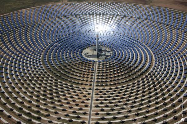

http://www.esolar.com/applications/ms-power/
Compare your system which requires water pumped towards it, in order to create steam to the system I proposed.
The molten salt is just required if you want to store energy, to use at night. In my case I proposed two extra basins which have a similar functionality but also can be used for tidal energy generation partly.

for reference
Aerial view of a concentrated solar power plant: thousands of curved mirrors arranged in concentric rings around a central receiver tower on a flat desert site.

Given two same designed molten salt solar power plants, one below ground and one on ground level, the one below using my method. Which one would generate more total energy?
That doesn't make sense. If one is below ground, it isn't of the same design as the one above ground. What other design differences will you have? One open and one closed?
russ_watters said:
Proposed design for what? I'm really not even sure what you are trying to do at this point. Do you want power or water? How much? Why? I have a nuclear plant 10 miles from my house and I get my water from a tap connected to a reservoir. Both are pretty cheap.
Tell that to the people that lived near Chernobyl or Fukushima.
You are really going to use the placement of a power plant as a design difference in the context I mentioned it? Have fun trolling someone else...
