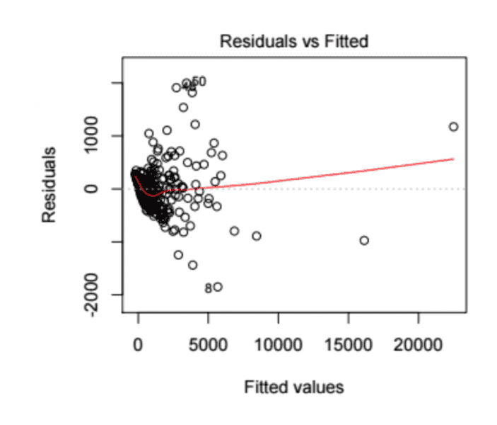

R residuals vs fitted values scatter plot with a red smoothed trend line; points labelled 50 and 8 mark extreme residuals, and most points cluster near zero fitted values.
What does the 8 and the 50 mean? I know that they are flagged values. Often, this happens. The plot is off because of some extreme points, the plot flags them, and I go into the dataset and cannot find them. Are they the built in row numbers of the dataframe? or are they something else?
This is a very program-specific question, which is not really in the main subject area of physicsforums. If you have no luck here the best place to ask is stack overflow, tagging your question as about R, graphics and regression. Stack overflow is designed for programming-specific questions, and I have always been able to find answers there.
That said, I have one suggestion. Since the plot points flagged with 8 and 50 have respectively the lowest and highest residuals, you could identify the numbers of the rows in the data to which they relate by which.min(mod$residuals) and which.max(mod$residuals) where mod is the name you have given to the model variable holding the results of the regression.
