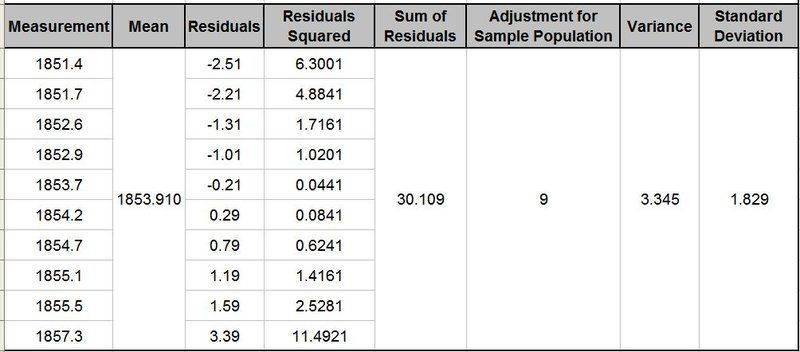

I am trying to understand how to interpret & create the probability density function plot from a set of data.
For example:-
  • Below is a set of measurements of the same table which I measured 10 times.
  • As you can see I have calculated the Mean, Residuals, Squared the residuals and summed up the Squared Residuals.
  • Because I can measure the table an infinite number of times (but impossible to do so) I only measured it 10 times, so 10 is my sample population and I have been told that I need to subtract 1 from the sample population which I have done so.
  • I have then calculated the variance and standard deviation.

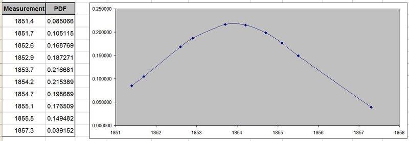

I have then used each measurement of my table along with the mean and standard deviation and put them through the probability density function. This is what I get:-
By plotting the measurements of my table (x) against the PDF (y) I get the following plot.
I know that to find the probability of a measurement of my table to fall between 1852 - 1855 for example then I would need to integrate the P.D.F from 1855 and subtract it from the integral of the PDF to 1852.

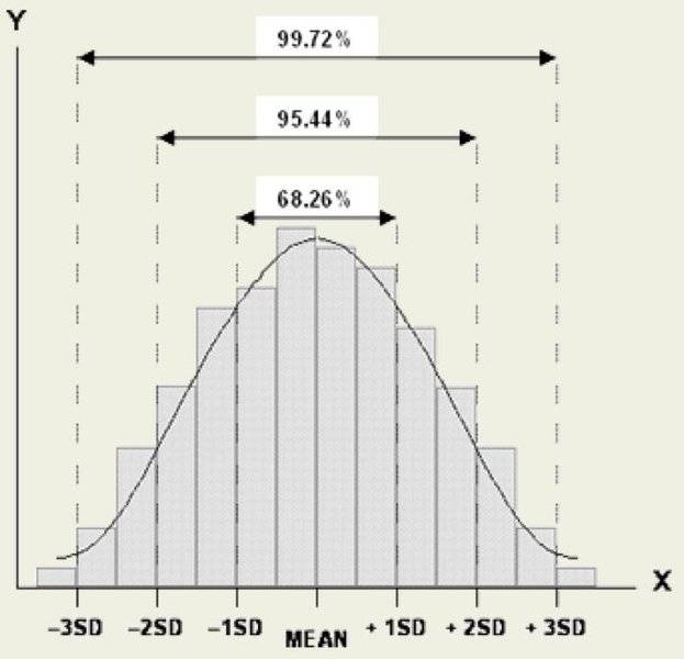

The question is how do I adjust this graph and data so that the mean is exactly in the middle and the x values are 1 2 and 3 standard deviations as shown in the example plot below:-

Is it just a plotting question?
Based on the mean and standard deviation estimated from your measurements, you can make a new table where you use (mean), (mean +- 1 standard deviation), (mean +-2 standard devations) and so on as points.
If you have a good reason to assume a known distribution of the random variable that you are sampling, then you can just plot that equation using the parameter estimates from the sample. In this case, if you know that the data is from a normal distribution, then you have an equation that you can plot.
If you want to base a graph only on the data without assuming that the data came from a particular distribution, then you can do it this way: First plot points of the sample cumulative distribution. Then fit a smooth curve through the points making sure that it starts at 0 at the bottom and ends at 1 at the top. Finally, plot the slopes of the CDF curve to get a PDF.

Thank your response, I was hoping you could explain two additional queries I am having trouble with.The first is this, my Mean is 1853.910 and SD is 1.829. I have integrated the probability density function from :-
  • -1SD to +1SD (1852.081 - 1855.739) and I get a value of 68.269%.
  • -2SD to +2SD (1850.252 - 1857.568) and I get a value of 95.44997%
  • -3SD to +3SD (1848.423 - 1859.397) and I get a value of 99.73707%
My question is what does 68.269%, 95.44997%, 99.73707% actually mean?
What does it mean to say that between +/- 1 SD it is 68.269%.
I think (but hoping you can confirm) that what 68.269% means is that if I randomly pick a measurement from my data set then there is a 68.269% chance that the measurement will fall within +/- 1SD.
Or can I say that for the data set to be considered a normal distribution then 68.269% of the measurements must fall within +/- 1SD.
