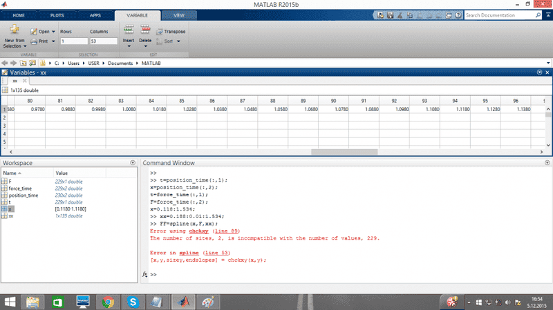

Thank you. But I have some trouble again.

You don't have the same number of values of x as you have of F.

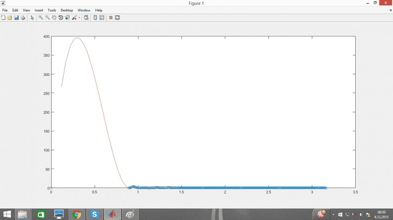

there's one problem again
1)I don't have 400 N but it still writes 400 N I don't know why ?

Could you show the plot
plot(t,F,'o',xx,FF)
ok
It doesn't work because you are extrapolating data outside the time range of the force measurements. I don't understand how come you have position data at such different times than force data.
