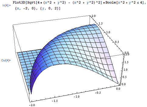

How can i get the image of a integral. Say i have a integral function like this
[tex] \int_{\pi/2}^{\pi} \int_{0}^{2} r\sqrt{4-r^2} drd\theta [/tex]
Now i want to see what volume the integral giving me. Which software i have to use for this purpose.
Thanks
For this particular integral, you can use any software that plots functions of two variables. In this case, I am assuming the third variable is z, as in cylindrical coordinates, and the integral is evaluating the volume under this surface:
A lot of free software offers this capability, including GraphCalc and Maxima. Note that you can replace r with [itex]\sqrt{x^2+y^2}[/itex] in order to enter the equation as z = f(x, y) if necessary.

That's in polar coordinates with [itex]\theta[/itex] going from [itex]\pi/2[/itex] to [itex]\pi[/itex]- in Cartesian coordinates, that is the second quadrant. r ranges from 0 to 2 so, within the second quadrant, we are within a circle of radius 2. Finally, the upper boundary is [itex]r\sqrt{4- r^2}[/itex] we can put that in Cartesian Coordinates by setting [itex]= \sqrt{x^2+ y^2}[/itex] so that [itex]z= r\sqrt{4- r^2}= \sqrt[x^2+ y^2}\sqrt{4- x^2- y^2}[/itex]. I doubt that is any 'standard' figure.
