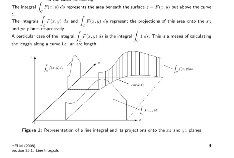

I know that's why it's done, but what I don't get is why there is the need, since with the integral, it essentially breaks it down into infinitesimal parts anyway. With an infinitesimal piece, I'm thinking all that should really matter is the location of that bit of it. That's what I'm having a hard time understanding. I would get it if we were measuring something on a larger scale and there was an arclength, but when broken down as an integral (and the limits concept behind them), doesn't it become infinitesimal, so that dimensions (like curvature of an arc) become irrelevant?
Maybe the picture on the first page of this PDF will help you visualize it:
https://www.lboro.ac.uk/media/media...HELM Workbook 29 Integral Vector Calculus.pdf
Or for those who can't click on it, it is the following:
Thank you for the help. Yes, it makes sense to me now. It should've days ago, lol. Just been extremely sick lately, so I was having a hard time processing it. I appreciate you, thanks!
