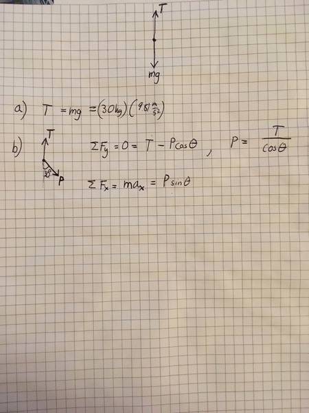

The girl weighs 30kg and her COM is at G. As she is passing the lowest position of the swing with rope length L=4.5m her speed is 3.6m/s. The swing and rope have no mass.
Calculate
a) the tension in the rope
b) the force P that is aligned along the girl's arms
see the picture below

This seems too easy...
If she was sitting on a stationary swing, the tension would be equal to the weight. However, this swing has a speed of 3.6 m/s so that equation is no longer true. The greater her speed, the greater the tension. You need something to relate those 2 parameters.

Ah of course, the centripetal force! I haven't done any physics since I graduated college and I'm trying to remember all the stuff that I learned years ago :).
If I call the centripetal force Fc= mv^2 / L
Then T= Fc + mg
and
P = T / cos(30)
correct? :)

That looks like a good start. :smile:
and
P = T / cos(30)
correct? :)
Be careful on part (b). Examine Figure 8 carefully. The force P -- the force aligned along the girl's arms -- is not the only force with an upwards component.

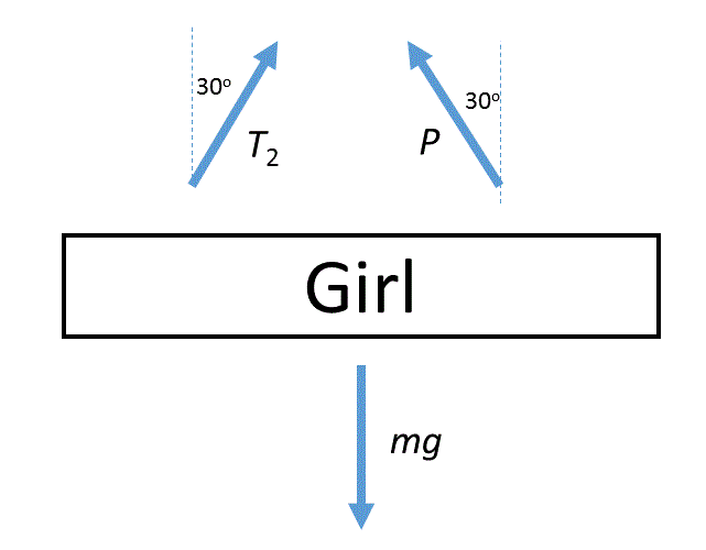

Regarding the tricky part I mentioned in my last post:
Consider the forces above and below where her hands are on the rope.
Above her hands, the tension on the rope is T. I think we all agree on that.
But what about below her hands? You know that the force P, acting along the girl's arms, contributes to the tension. But is that all? Is there anything else?
I think I was thinking about it wrong, I think I was approaching it as a statics problem where the sum of the forces is equal to zero when I should have thought about it as Fc=T-mg. It's starting to make more sense now.
As for forces below her hands... Hmm, would it be mg? That's the only one I can think of.
edit: but that would be down...
I really don't know, I can't think of another force that's pointing up.

Maybe it's easier to think of things in terms of tensions.
The vertical component of the tension in her arms together with the vertical component of the tension in the rope below her hands must combine to a total, vertical force T.
Recognizing that, you could draw a free body diagram showing the forces [on the girl].
Does that help?

I would draw the FBD considering the forces acting on the girl.
What must the vertical components of T2 and P add to? (Hint: it's not mg. She's accelerating up, remember. But it is something you've already calculated.)
that makes a lot more sense. For some reason I was having a really hard time drawing a fbd of the girl.
So then I get
mv^2/L = T - T2cos30 -Pcos30
mg=T2cos30 + Pcos30
correct?

No, not quite.
You had the tension T part correct before back in post #3.
The vertical components of P and T2 don't sum to mg. (She's accelerating don't forget.) They sum to form what? (How do you describe the vertical force in the rope above her hands again?)
Okay so all those three forces must equal the centripetal force then?
Fc = T2cos30+Pcos30-mg
Fc=T-T2cos30-Pcos30
Yes, in this case. Correct. :smile: Newton's second law fits in there if you want to be thorough.

Feodalherren said:
I assume that Fc=T2cos30+P2cos30-mg is correct.
Yes, that looks correct to me. :smile:
My only other guess would then be that T=T2cos30+Pcos30, but that's a guess and it feels wrong.
That equation is correct! :woot:
You know that the total, vertical upward force from the rope is T, right?
You also know that the total, vertical force acting on the girl from the system of arms and ropes is T_2 \cos 30^o + P \cos 30^o.
The total upward force (from rope/arm system) acting on the girl is the same as the total upward rope force, right?
So T_2 \cos 30^o + P \cos 30^o is T.
They're not just equal. They are the same thing.
