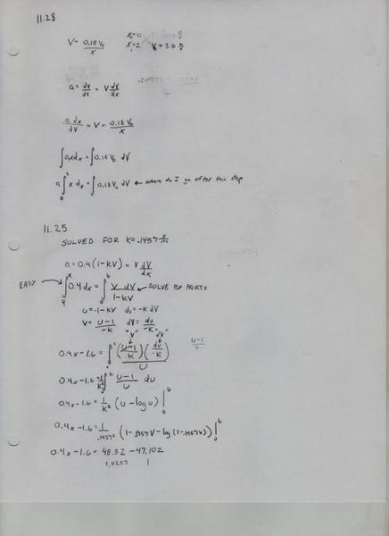

for the second part I am stuck...here is my work... this is problem 11.25
I do not understand your last line. It is all right up to then.
After integration, you got:
[tex]0.4x-1.6=1/k^2[1-kv-ln(1-kv)]_0^6[/tex]
Substitute first v=6, then v=0, and subtract. But how did you get that 48.32?
1-6k-ln(1-6k)=0.1258+2.07317=2.1989, and divided by k^2: 103.6
ehild
