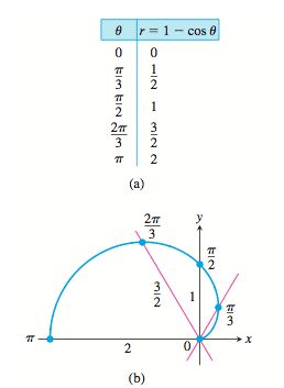

Table (a) lists theta against r = 1 - cos theta: 0 gives 0, pi/3 gives 1/2, pi/2 gives 1, 2pi/3 gives 3/2, pi gives 2. Graph (b) shows the upper half of a cardioid in the x-y plane with labelled points at pi, 2pi/3, pi/2 and pi/3.
I don't see how they get
1 - cos (pi/3) = 1/2
cos (pi/3) = √3/2
1 - √3/2 = .14, not .5 like the book says
for the other figures I agree with the book.
What's not to get? cos([itex]\pi[/itex]/3) = 1/2.
You need to brush up on your trig.
bobsmith76 said:
cos (pi/3) = √3/2
No, this is not true. sin([itex]\pi[/itex]/3) = √3/2.
