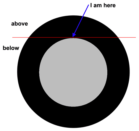

As usual, lack of precision on my side :redface:
I am somewhere inside. Earth mass consist of inner and outer part (which are what you defined as above and below). Outer shell has part that is below and above (my definition of above/below), and their attractions cancel out. Above and below are separated by the plane (marked in red). Inner sphere is what is left attracting.
It is a little bit convoluted, but it better fits my feeling about what is above/below. In the end it yields the same result.

Ah... so 'above' and 'below' refer to the two parts of the outer shell. OK, now what you said makes sense.
You are one crazy dude, Borek! :-p

But, if we try and resolve that formula given by haiha in post #2 with the graphic explanation given by Borek, we would have to modify that formula to state F = 4/3(pi)(2r-R)mp, to take into consideration the force that is cancelled. I still don't see from that graphic, though, what the masss "above," i.e. radially toward the surface, geometrically cancels with. I am assuming I am missing something, but still, since it cancels, wouldn't it have to be subtracted... from haiha's formula?

No. Haiha's formula describes the full gravitational attraction experienced by a mass at some distance from the Earth's center (when that distance is less than the radius of the earth). It includes the attraction from all parts of the earth.
You can divide the Earth's mass into two pieces:
(1) the part of the Earth that less than or equal to a distance 'r' from the center; think of this as the inner core;
(2) the part of the Earth that is greater than a distance 'r' from the center; think of this as the outer shell.
It just so happens that the gravitational field from a uniform shell of mass is zero at all points within the shell. (This was proven by Newton long ago; it is one of Newton's Shell theorems.) That means that the outer shell (2) does not contribute to the force felt by the mass at location 'r'. All of the gravitational force at location 'r' is due to the attraction of the inner core (1).
What Borek was doing was dividing the outer shell (2) into two parts: a part 'above' and a part 'below'. The attraction from each of those parts cancel. (His terminology confused me at first.)

This is the explanation I have been seeking. Embarrassed, I have to admit I was unaware of Newton's Shell Theorems. I will sleep better tonight. Thank you. :smile:
