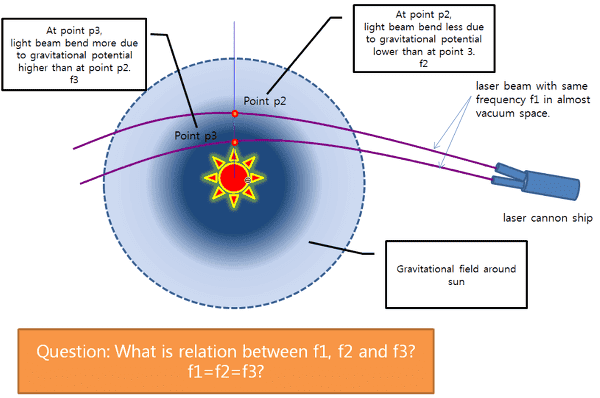

Hello,
This is my first post and I have one question.
My major is not physics. For now, I am struggling to understand general relativity for own reason because the math involved is troublesome to me but facing one question I need to figure out.
It is related with the gravitational lensing effect. I made a picture to help you understand my question better.
I heard that Einstein's general relativity provide the most correct picture about the geometrical curvature of space-time and mass is the source to warp fabric space-time. So light emitted from distant galaxy always moves straight line on the flat surface of space-time in vacuum but straight line on the warped surface of space-time in gravitational field near sun.
My question is that is there any change in the frequency or wavelength of beam bent within gravitational field near sun?
Let me describe morel from the picture above. Let's assume that a ship with double gun laser far away from sun and single laser source with frequency f1 at position p1 shoot laser beam through two gun at the same time to the direction of sun such that two beams bend slightly differently and passing through p2 for upper gun and p3 for lower gun. The path from p1 to p2 is equal length with the path from p1 to p3. The energy of two beams emitted from the ship is ##E = hf_1 ## .
With such preparations, let suppose two observers are positioning at p2 and p3 and their watches are synchronized already such that they can start and complete measurement at the same time. Time synchronization is required due to the gravitational time dilation. Their task is to measure the frequency of the light beam from the ship.
Now here is my question. What is the relation between f2 and f3? Are they same or different? If different, which one is higher? What general relativity predict? Is there any experimental results? My best guess is what general relativity predicts would be f2=f3 but not sure.I would appreciate for any help or guide.
No; GR predicts f2 < f3. But the reason has nothing really to do with gravitational lensing; it simply has to do with gravitational blueshift--light that is "falling" into a gravitational potential well blueshifts as it falls, and the deeper it goes, the more it blueshifts. So since p2 is not as deep in the Sun's gravity well as p3, the laser light that "falls" to p2 will blueshift less than the light that "falls" to p3. Blueshifting increases the frequency, so less blueshift means lower frequency, i.e., f2 < f3. (But both f2 and f3 will be larger than f1.)
I suspect the question you really meant to ask is whether the lensing process itself, i.e., the different bending of the light beams passing through p2 and p3, produces any frequency change. AFAIK the answer to that is no.
There's one common clock the observers use, and that causes them to measure same frequencies for the two beams.
If two clocks are forced to be in sync all the time, there's really just one clock.
Let's say the upper clock is the master clock. In this case the lower observer might say: "Light blueshifts by 10% when traveling through potential difference between upper observer and me, and I'm forced to use the upper observers clock which is 10% too fast."
Ok, I missed that. But in this case, what I am still wondering is that the blue shifted beams of f2, f3 higher than f1 means that the beam energy are increased by the amount of h(f2-f1) and h(f3-f1) and the additional energy come from the gravitational field of sun. My basic understanding is that the energy of light is proportional with the measurable frequency.
Yes, that was exactly what I meant to ask. Is the answer verified by experimental result or just prediction only? I am searching for both the prediction of GR and the verified result. Any similar verification would be good.

flexible_time said:
If I read you correctly, the kinematic energy of electron at p3 in higher gravitational potential will be greater than the electrons emitted from the metal plate at p2 in lower gravitational potential.
p3 is at a lower gravitational potential, not higher. (Think of gravitational potential as altitude--p3 is at a lower altitude than p2, hence a lower potential.) But yes, the UV photons received at p3 will have higher frequency, hence more energy, hence will cause the emission of photoelectrons with more energy (as measured by an observer at rest at p3), than the UV photons received at p2 (as measured by an observer at rest at p2).
