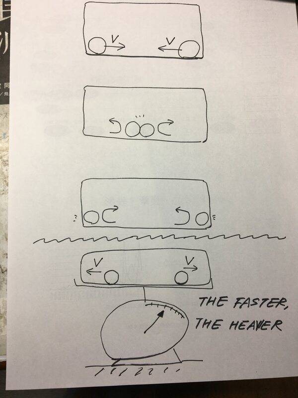

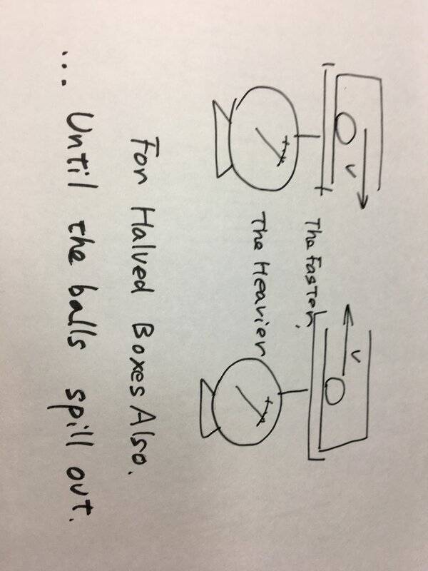

Hi Jim
Say the two bodies are the Earth and a moving ball. I am not sure how to measure force on a moving ball so let us make a pair of horizontally and opposite moving balls in a box and measure weight of whole box as sketched. In this setting the faster the balls move, the heavier the whole box weighs.
