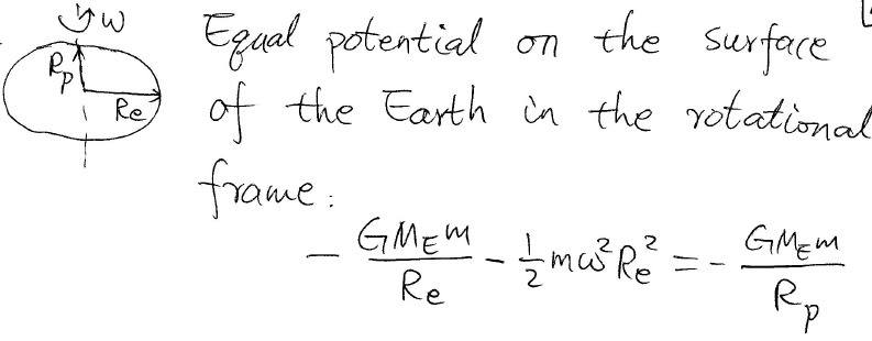

erm i met another hurdle
this time its about gravitational potential
apparently the gravitational potential on the Earth's surface is constant
so the equation given is -Gmm/r(equator) - 1/2mr(equator)^2ω^2 = -Gmm/r(pole)
anyone know what equation is this? i know the 1st and 3rd term are the potential at the equator and poles respectively but what is the 2nd term? it looks like rotational centripetal force * r(equator). but why?
thanks a lot!
It must represent the rotational Kinetic Energy, I suppose. That would be, for example, the energy 'helping' rockets to take off when they are pointed Eastwards, rather than upwards or backwards. I have a feeling that the sign of the term should be positive rather than negative, as shown, because, if you are using this KE then your potential is effectively less negative.
issn't rotational kinetic energy 1/2Iw^2? the moment of inertia I of the Earth is 2/5MR^2 right? so it wouldn't make sense if we sub in ?
so how did it become 1/2mr^2w^2?
Surely it's the KE of the object and not the rotational energy of the Earth that counts in this one?? It's the KE of the rocket what helps it 'get off' and not the KE of the launchpad etc.
It would help if we used M and m, I think.
hmm.. i don't really understand. my lecturer gave his answer as this , hope it helps.
That second term (-½mω²r², where r is the distance from the axis of rotation) represents the potential energy due to the centrifugal force that appears when you view things from a rotating frame. Note that since the force is outward, the centrifugal PE becomes smaller (more negative) as r increases, reaching its minimum value at the equator where r = Re. (At the poles, the centrifugal PE term is zero since r = 0.)
An equipotential surface would be squashed at the poles and stretched at the equator.
Yes. The small m and big M in the equation make perfect sense now. It's like I said. The fact that you're spinning around the Earth when you are at the Equator means that you need less energy to get away to infinity (which is what is meant by your Potential Energy). They all use it in real space shots.

issn't centrifugal force a fictitious force? how did that have a potential energy now?
erm so why does taking the centripetal force term ½mω²r multiplying with r gives the potential forcE? its like force times distance which is work done? same units but why is this potential energy? is there a derivation or something? because i only know that rotational KE is 1/2mw^2 ?
quietrain said:
isn't centrifugal force a fictitious force?
It's 'real' as observed in a rotational frame. The confusing issue here is that GPE uses ∞ as the reference, while the CPE (centrifugal potential energy in this rotating frame) uses 0 as the reference.

For CPE:
<br /> F = \frac{m v^2}{r} = \frac{m \ \omega^2 r^2}{r} = m \ \omega^2 r<br />
<br /> U = -\int_0^r \m \ \omega^2 r dr<br />
<br /> U = -\frac{1}{2}\ m \ \omega^2 r^2<br />

But the equation in the attached image in the previous post is compensating for the increased GPE due to larger radius, by subtacting |CPE|, implying some exact relationship between the radius of the Earth versus the latitude and the associated centrifugal force in the rotating frame.
CPE (centrifugal potential energy in a rotating frame) decreases (becomes more negative) as distance increases. GPE increases (becomes less negative) as distance increases. Although including the CPE component decreases the total PE (GPE + CPE) at the equator, I doubt the equation in the attached image is correct, unless it's implies some abstract model of the earth, just flexible enough to flatten at the poles and expand at the equator for that equation to hold true. The equation fails in the case of a rigid Earth where the radius at the poles and equator are the same: Rp = Re.
In a non-rotating frame of reference, the total mechanical energy of a two body system is normally defined as E = GPE + KE = -GMm/r + 1/2 M V2 + 1/2 m v2. The CPE from the rotating frame of reference = -1/2 m v2 = -KE of the smaller object (since the rotating Earth is the frame of reference, V=0). I'm not sure what the usage of a rotating frame of refernce is trying to accomplish.
wow.. i mean this is the first time i come across such a thing as centrifugal potential energy. all along , the only energies i learned are PE KE and spring PE. so how come all of a sudden we have a CPE?
does it mean that i can integrate any other forces to get their revelant energy? like integrating centripetal force to get Centripetal potential energy? also why is it not centripetal PE in this case?
I'm sure that that's what they are talking about--a plastic Earth that is able to conform to the equipotential surface, something of an oblate spheroid.
That is correct. The name for that surface is the geoid. Another name is mean sea level.
But the Earth isn't a perfect rigid sphere, Jeff. The Earth is a deformable plastic blob. Earth's surface is close to being in isostatic equilibrium. In other words, the Earth's surface is fairly close to the geoid.
If the Earth was a rigid sphere, the oceans (and the atmosphere) would be piled up around the equator. The air at the poles would be very, very thin.
"If the Earth was a rigid sphere, the oceans (and the atmosphere) would be piled up around the equator. The air at the poles would be very, very thin."
I think you need to reconsider that statement. The difference in radius is very small and the difference in g is, in fact, ' the wrong way round, with less g at the equator, not more than at the pole. The centrifugal (there, I said it and I don't care) effect is much less than the effect of g so the sea and atmosphere are merely thrown a bit 'uphill' towards the equator. There is plenty of restoring force to stop them all glooping to the equator.
No, DH has it right. If the Earth were a sphere instead of a geoid that would mean that it would be lower at the equator and higher at the poles than it is now. So, more ocean and atmosphere at the equator and less at the poles compared to now.
