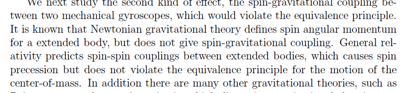

Now I am not so sure. The following source reiterates my prior claim:
https://arxiv.org/abs/gr-qc/0006075
The correct question to ask for a Kerr BH would be whether the "center of mass" (by some reasonable definition) of a small (there is no lower size limit) Kerr BH orbiting e.g. a star moves differently than a small nonrotating BH (making them small removes GW issues from the picture). If this happened, you would have a violation of the WEP and weight would different from mass. The literature claims there are no known predicted violations of the WEP in GR (except charge couplings between a charged particle and its own field, which are excluded in careful definitions). I have not been able to locate any literature on the motion of a Kerr BH in a background geometry, but would now expect that it would not violate the WEP and thus there is no sense in which weight of spinning object (even extreme) is different from its mass (to the extent classical GR is true).
That is quite surprising. To my knowledge trajectories around a BH depend on its angular momentum. In order to make this happen without affecting the trajectory of the BH itself, the differences in energy and momentum would need to be emitted as gravitational waves. Is that the case?
