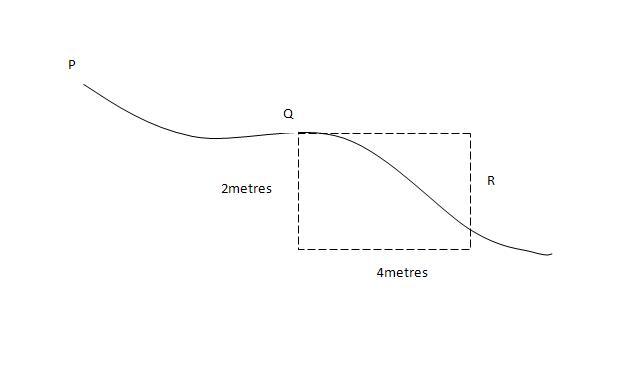

The profile of a ski slope is shown below. The section QR inside the dotted box is parabolic in shape. The ski slope at point R is at 45degrees to the horizontal
A 75kg skier moves down the slope from P to Q and continues to R and beyond. Assume that the skier is a point mass, and air resistance and friction are negligible.
Question1. Is it possible for the skier to experience weightlessness while moving along the entire path QR. Explain.
Question 2. To achieve the situation in question 1, the skier must move at a certain speed at point Q. In terms of V, what is the magnitude of the vertical component of the skier at point R.
W=mg and perhaps a=gsintheta
acceleration due to gravity is 10m/s/s and has to equal gravitational field strength of 10 N/kg.
Using a=gsintheta, i substitue angle 45 to get 10sin45 which equals 7.07m/s/s. Not sure if this is correct so far. Dont know wehre to go now.

1. The question is asking whether it is possible that there would be no normal force acting on the skier during Q-R (ie. the skier is doing a jump and is in the air during Q-R). How would that occur?
2. Think of an object in free-fall. What is the initial vertical velocity at Q? What is it in terms of h - height fallen - after Q?

Whether he is in contact with the slope is the issue. It says is that he follows the slope from P to Q and continues to R and beyond. It does not say he follows the slope from Q to R. If he follows the slope from Q to R he obviously has a normal force acting on him so he is not weightless.
Since the second part of the question suggests that 1. is possible (ie. he is weightless for the entire Q-R portion) the interpretation I have given above must be correct. If your interpretation (that he follows the slope from Q-R) is correct then it is impossible that he is weightless during the Q-R portion.
As a further hint in solving this: assume that the skier at Q moving with a velocity v which is entirely horizontal experiences freefall from Q-R. What is the shape of his trajectory?

No. For the skier to be weightless from Q-R he has to land at R, not before. You have to work out the horizontal speed that will provide that horizontal range (4 m.) in the time it takes for the skier to fall the stated distance (you have to work it out from the fact that R is on a parabola - slightly less than 2 m.).

[Note: In looking at the diagram again I may have misled you. It looked to me like the curve turned up before R putting the apex after R. But I think it was intended to be a parabolic path downward with the apex at Q.
In that case, your original thought that the skier followed the curve will work if the free-fall path from Q to R is the same as the curve. There would be no normal force if the skier just about touches the slope, but not quite.
The analysis is the same as I suggested, it is just that he is in a free-fall path that is arbitrarily close to the slope. It can work because the free-fall path and the slope are parabolas opening downward.]
Write out the equation for the slope:
y = -kx^2 . Can you determine the value for k? Are you given the exact vertical distance below Q at R? It looks like it is almost 2 m. but not quite.
The freefall path is: y = -gt^2/2. What is t in terms of x and v (horizontal speed at Q)?
If you can determine k you can find v.

Why +2? I would put the origin at Q.

Because the condition for weightlessness is y = -gt^2/2 \ge -kx^2 (ie. the free-fall path is at or above the slope. If it is below the slope, the slope pushes up on the skier (ie. preventing the skier from following the free-fall path).

You can find k from the slope at R.
I get k = 1/8 and v =2 \sqrt{g} = 6.26 m/sec[/tex]<br /> <br /> AM

You are welcome. I just wanted to point out that the diagram is misleading.
The equation for the path in the QR rectangle is:
y = -x^2/8
so for x = 4 m, y = -2 m.
R has co-ordinates (4,-2) which is not how it is drawn.
