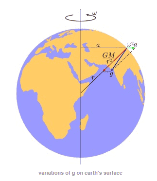

Thanks ILS, allow me to ramble a bit please - I know I have a weakness in visualising fields, just not much practice...
You've helped me see nicely the scalar gravity field itself - different values at diff. places on the surface of the earth, (I must remember to remember these have no direction!). The field itself is g, a scalar function of $\phi$ - which is directly the latitude coord, 0 at the equator, +/- 90 at the poles? If so, and we are south of the equator, wouldn't $\hat{\phi}$ increase southward?
Isn't r the radius coord of the Earth (which we don't know)?
My book says the gradient is $\perp$ to the surface of the field, but the eqtn has it parallel to the surface? I don't just want to apply formula and hope :-)
Attached is the best image I could find, not very useful ...View attachment 4948
It's a nice picture that shows how we vector $\vec g$ is determined, which as you can see, points slightly southward, while the gradient of the scalar $g$ points slightly northward.
