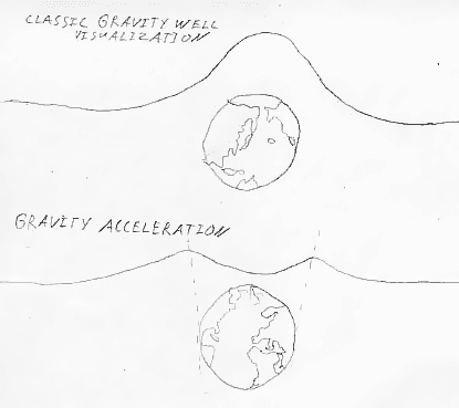

Now, if we put one clock at the center of the Earth, and one on the surface, what will be the result?
What i mean:
There is no gravity acceleration in the center of the Earth due to it's own mass and "the space is flat" for what i can comprehend, so will the time rate be the same as in relatively flat outer space near Earth, faster than on the surface, same, slower, or entirely different?
If it will be slower than on the surface, then what is physically different in the center of the Earth (harsh pressure/temperature conditions aside) that causes the dilation?
What i mean:
The upper picture (gravitational potential) is more related to gravitational time dilatation.
If you are interested in more accurate visualizations of curved spacetime inside and outside of a sphere mass:
http://fy.chalmers.se/~rico/Theses/tesx.pdf (chapter 2)
http://www.adamtoons.de/physics/gravitation.swf

Now that makes the best sense of all - i completely missed the point that time dimension is stretched by gravity too. Then, it is a question of difference of stretching between observers to get a time dilation, not the force of gravity of some kind.
Thank you all for help.
