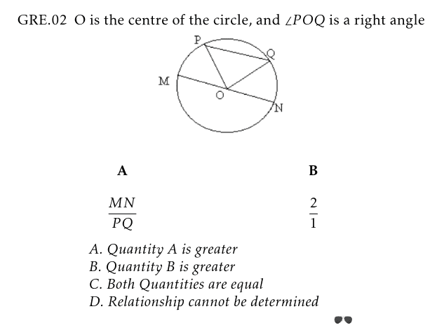

GRE geometry problem: circle with centre O, points P, Q, M and N on the circumference, angle POQ a right angle, MN a diameter; quantity A is MN/PQ, quantity B is 2/1, with answer choices A to D.
ok this is an observation question but many seem to miss the answer
What theorms would rely on to get the correct answer
let $r$ be the circle radius …
$\Delta POQ$ is a right isosceles triangle
$PQ = r\sqrt{2}$
$MN = 2r$
$PQ = r\sqrt{2}$
$MN = 2r$
so $\dfrac{2r}{r\sqrt{2}}=\dfrac{2}{\sqrt{2}}\approx1.43<2$
which is B
$\dfrac{2}{\sqrt{2}} = \sqrt{2} < 2$
no need for a decimal representation … unless you are “old school” and can recall $\sqrt{2} \approx 1.414$
