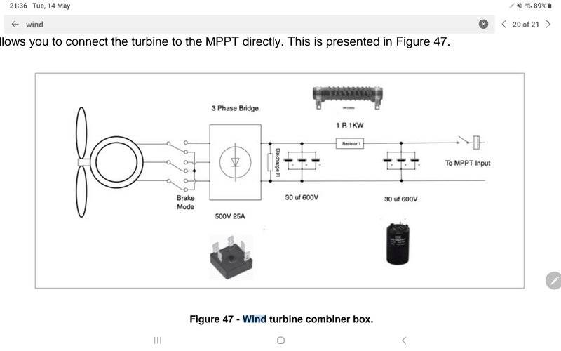

  1. Rectify the AC power output from the alternator to DC (using 50A full bridge rectifier, appropriate smoothing caps and dump & discharge resistors).
  2. Feed this DC power into the MPPT input of a 10 kW or 20 kW grid-tie inverter.

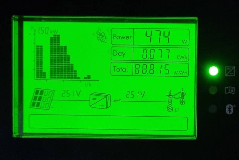

So I ran a test today with a smaller 300W single phase AC pelton generator.
Using a 50A 1000V full wave bridge rectifier for AC-DC conversion, I connected two 45uF 440V capacitors in paralell on the DC side, including a light bulb and switch for discharge, then straight to one of the MPPT's of a SunnyBoy Tripower 12kW grid tie inverter.
We opened the valves, and then.... EUREKA!
It worked like a charm, producing way above what we expected it could. The peak power measured was 580W with the voltage staying around 250VDC (see attached image).
The next step is to take our old Lister generator apart and fit the alternator to the old pump, and then, hopefully, produce anything between 8 - 10 kWp.
I will keep you posted on the results!
(Also see attached snippet from SunSynk manual, showing schematics of wind turbine integration. My layout is exactly similar, except that I left out the smoothing resistor, used smaller caps, and generating single phase instead of 3 phase AC.)
