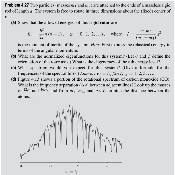

Two particles are attached to the ends of a massless rigid rod of length ##a##. The system is free to rotate in three dimensions about the (fixed) centre of mass.
What spectrum would you expect for this system?
Determine the distance between the atoms.
##E = \frac{L^2}{2I}## where ##L## is the angular momentum.
I have included a screenshot of the question as we need to use the figure for the last part of the question anyway.

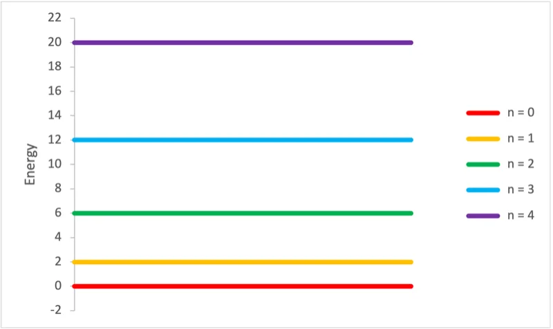

OK. See my addendum to post #2. Can you produce an energy level diagram? Note that the zero of energy is arbitrary, so you might as well call the energy of the ground state zero and then find the energies ##E_n-E_{\text{ground}}~## above it.
If our ground level is zero then:
##E_n - E_{ground} = E_n = \frac{h^2}{2I}n(n+1)##??

Look at the modified figure below. In view of what you read, describe what it shows.
The horizontal axis is energy in units of cm-1. Find out how this unit of energy is defined. Then answer the questions following the figure.
Questions to answer:
  1. The colored lines show values of energy. What do these energies represent?
  2. Write mathematical expressions for each of them.
  3. The spacing between adjacent lines appears to be constant. How does your mathematical formulation in your answer to question 2 account for this?

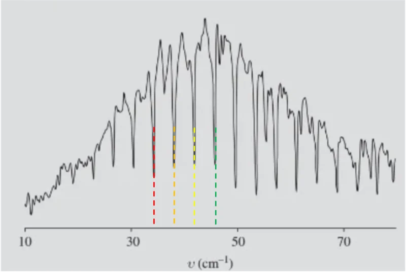

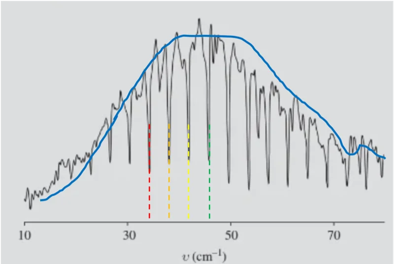

Look at the picture below. Imagine the vertical to be Intensity of detected radiation and the horizontal axis to be photon energy detected by the detector. Also imagine the blue line to show what you get without the CO sample in place. It is a featureless blob. With the CO in place you get the structure in back with all those dips, four of which are labeled with the coloured dashed lines. These dips show loss of intensity at specific energies.
For example, the red dashed line occurs at about 34 cm-1. First explain with words, not equations, what energy that is. Then write a mathematical expression for it. Do the same for the orange dashed line and the energy at 38 cm-1. The distance, in energy, between the orange and red dashed lines is 4 cm-1. Write another mathematical expression for it.
Do all that first and we'll take from there.
Okay. Light is made of photons. Different colour photons have different energies. Intensity is the amount of energy per second per unit area. The red line shows a dip in the intensity of detected radiation. This means that the sample of CO has absorbed energy. Is that correct? @kuruman
That is correct. Let's continue incrementally. Please answer the following three questions. We are doing part (d) now and, in so doing, we will verify part (c).

Okay I just looked at the question again. The distance between the dips looks pretty constant. So we just say:
$$\Delta \nu = \nu_j - \nu_{j-1} = \frac{\hbar}{I} \approx 4 \implies I = \frac{\hbar}{4}.$$
We know ##m_1, m_2##. Hence we can get ##a## from the formula
$$I = \frac{m_1 m_2}{m_1 + m_2} a^2$$
