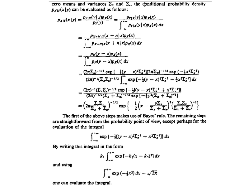

Could someone please advise me how to put the integral from + to - infinity notation used $ exp{-1/2(y-x)^2(A^-1) + x^2(B)^-1}dx Into the form k1 $ exp[-k2(x-k3)^2]dx using the fact that $exp(-1/2x^2)dx = 2pi^1/2
I have encountered this problem when trying to derive the conditional density function of p(x|y) where y = x + n, where y is a gaussian random variable and is the sum of two other random variables.
Help really appreciated with this - yhanks - - Ems x

Hi - thanks for your patience with me - I have added as an attatchment the problem I am trying to work through - its the evaluation of the integral, I apologise in advance if my notation wasn't accurate - I tried my best - Thanks x

As I have said previosuly y is a random variable (r.v) which is gaussian it is made up by the sum of two other independent random variables x and n so y = x+n
OK. So the formula in your original post was wrong. And I guess that in your previous posts you were using a dollar sign to represent an integral. That clears things up a bit.
You said, "k1 is of the form AB/(A+B)". Why? I don't see anything in the problem you posted that says that.
Anyway, you deal with this with or without substituting for y. If you substitute y = x+n into the integral it'll be simpler to evaluate. You can then backsubstitute n = y-x in the solution to get it in the form they have. Or you can expand the (y-x) term, collect terms in x, and complete the square to get it in the k1/k2/k3 form, with the k's depending on y. This is apparently what the writer's expect you to do. It will also work.
Finally, you have to evaluate the integral. By substituting u = (x-k3)/sqrt(k2), you will be able to put it in the form whose value integrates to sqrt(2pi). Everything else in the solution comes from k1 (the exp{stuff} factor) or from the factor of k2 (the stuff^(-1/2) factor) you pull out of the integral after substitution.

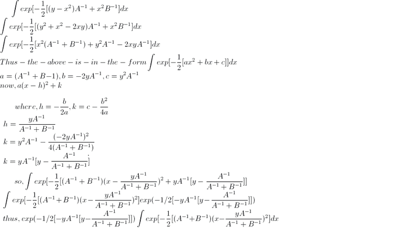

I have done as you said, expanded without substituting for y to collect terms in the form Ax^2+bx+c
exp[-\frac{1}{2}((y^2+x^2-2xy)A^{-1}+x^2B^{-1})]
exp[-\frac{1}{2}((x^2(A^{-1}+B^{-1})-2xyA^{-1}+y^2A^{-1})]
I am having trouble completing the square of this above equation and also removing a common term which can hold as k1

So, you have an expression a x^2 + b x + c. a = (1/A + 1/B), b = -2y/A, and c = y^2/A, if I'm reading this right. Just follow the procedure for completing the square in the Wikipedia article I pointed you to, or in my post #4, if you can get LaTex to work. Once you complete the square, you'll end up with something like exp{a(x-h)^2 + k}, where k doesn't depend on x. You write that as exp{k} exp{a(x-h)^2} -- exp{k} is (or contributes to) k1.

So I have gotten this far (as attached) - the integral is now in the form as required - I am having a lot of trouble solving it - could you please offer any tips - do I need to factorize anymore - I appreciate your help - I need to get use to this maths (again) -

OK, that's a definite integral from -inf to +inf. You need to do a substitution u = ax + b to make it looks like the integral you know, whose value is sqrt(2pi). When you do that the dx will turn into du/a, and you'll pull the 1/a out of the integral -- it'll become part of the final answer.
