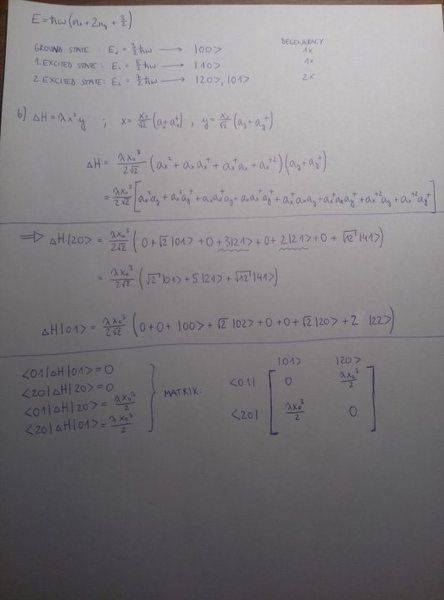

I tried to solve the b) part on my own now, the photo is on the bottom of the post. I really hope it is correct, can someone please check it?
I am just wondering about that final matrix down there. We learned that the matrix should be antisimetric, but I don't find any minus anywhere?
Photo:
Sorry but the picture is too small.
gasar8 said:
antisimetric
Really? Given that the perturbation is Hermitian, this implies that the off-diagonal elements must be purely imaginary. However, the action of the ladder operators onto the kets always results in a real constant prefactor. I don't see why the off-diagonal matrix element should be purely imaginary.
Sorry, I thought it can be enlarged. Here's the link: http://shrani.si/f/1s/g6/3Zw6xWnV/4/20160225183031.jpg
Ok, maybe I misunderstood our profesor. :)
Overall, looks pretty good. But when writing x and y in terms of creation and destruction operators, is the xo factor the same for y as it is for x?
To shorten your calculation somewhat, note that when calculating
##\left< 2, 0| \textrm{sum of a bunch of products of creation and destruction operators} | 0, 1 \right>##,
you should be able to see that the only contribution will be from a term that raises 0 to 2 for x and lowers 1 to 0 for y. So, the only term that contributes will be ##a^\dagger_x a^\dagger_x a_y##.

Isn't it? We have [itex]x_0=\sqrt{\frac{\hbar}{m \omega}}[/itex], so the ω is the same, and mass too? Or do I have to take into account ωx and ωy again?
Hehe, nice hack, thanks. :)
Yes, you do. The y part of the unperturbed Hamiltonian acts like an independent harmonic oscillator with its own ωy.
