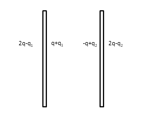

I tried to calculate the final charges, not sure if I am doing it right. I assumed that the charges on each side of left plate changes by an amount q_1 and on the right changes by q_2. (see attachment). Since electric field is zero in the middle, electric field due to right side of the left plate is canceled by the electric field due to the left side of right plate. From here I get ##q_1-q_2=2q##. I don't know how to proceed from here.

Pranav-Arora said:
There will be no electric field in the middle of plates, therefore there will be no energy.
You are doing the thing I told you that you don't have to do. You already know the E field is zero. That's the important thing. Do you actually want to solve this or solve the heat problem part?

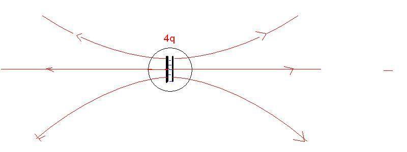

Pranav, when the plates get connected, they become a single conductor, one side having more charge than the other. What happens if you touch a metal plate with a charged rod? The charges go over to the plate and disperse on it till the charge density is the same everywhere. The same happens here, the two plates are equivalent, the 4q charge will disperse evenly on the plates.
Now look at the picture. The two plates with their 4q charge look a single tiny charged object from far away. (At great distance, the field is like that of a point charge), and the field outside the plates does not depend on the field inside. The energy of the whole set-up is the sum of the field outside and the field inside. When the plates are connected there is no field inside. So what is the energy difference between the field before and after connecting the plates?

Nice explanation ehild. Thanks! :smile:
The energy difference is equal to the energy stored between the plates before the switch is closed.
Maybe more accurate to say that the 4q charge is evenly spread over the outside surfaces of the plates? There won't be any to speak of on the inside surfaces.
