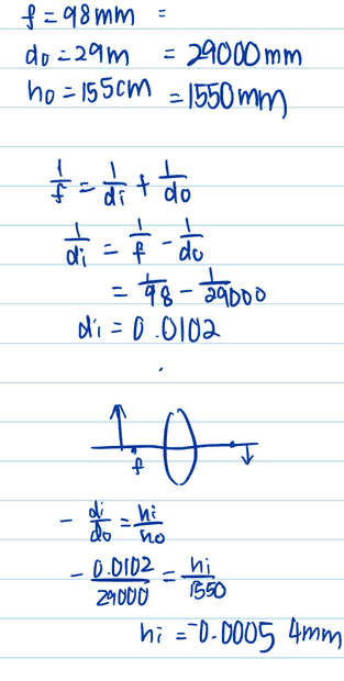

You have a movie camera with a single lens of focal length 98 mm. You would like to take a picture of a friend who is standing 29 m away. Your friend is 155 cm tall, what is the height of the image of your friend on the film in mm?
1/f+1/di+1/do
Hi, I just want to check if my working is correct cuz I seems to get the wrong answer in my first attempt by inserting 0.054mm as the heigh.... the height seems a bit small to me.
Check again your conversion of the 29 m distance into cm.
And make sure you get the distance image in the last step.
All conversions were to mm.
syllll_213 said:
Check your calculation of ##d_i##. There is something you forgot to do.
