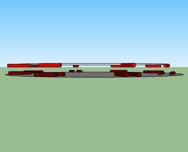

Hello all!

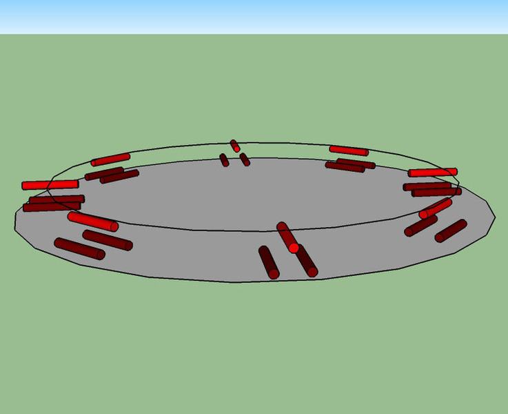

Im a young sculptor from croatia on my last year of sculpting... I am planning in making this element that will levitate and have a rough blueprint for you to tell me would it roughly work... the setup is ready for experimenting but the basic physics arent clear to me... did i imagine it right. So here is the drawing i made
So bottom row will be fixed all on one plate and magnets above will also be connected by element
all magnets are repelling against each other, and are inserted so they are sandwiched in between... they wouldn't move because configuration of the magnets... the one set of three wouldn't allow for x movements and the other sets wouldn't allow y movements... I think u understand by now...
What do u think??
There is no arrangement of magnets that will do this without some sort of active feedback.

Earnshaw's theorem doesn't apply here. What you've done is provide a mechanical constraint, namely the plastic that holds the magnets in position. This is analogous to having a hollow cylindrical tube and dropping two cylindrical magnets into it with opposite orientation. Obviously the top one will levitate. It "wants" to flip over, but can't because of the external mechanical constraint of the plastic. Your magnets "want" to flip over, but can't because of the external mechanical constraint of the plastic.
The video shows a magnet being stabilized by a plastic plate. The plate is providing the force that keeps the magnet from sliding off in that direction.
In your setup, you have rigid constraints between your magnets, but there is nothing rigid constraining the motion between the top half and bottom half. I'm pretty sure it's not possible to be stable this way.
I couldn't find a written proof for Earnshaw's theorem for extended objects, but I think it follows from linearity of the gradient function. So, if you add together two divergenceless functions, then the result is also divergenceless. The force of an extended object is the sum of external forces on each part of the object. (That's because the internal constraint forces between parts of the object cancel out over the whole object.) So, the whole thing feels a net force from a sum of many divergenceless fields. So, to avoid Earnshaw, you need a constraint force between parts of different objects.

My setup is same as the video, but xy movement is constrained with magnets in ring formation that are x y positioned and x is keeping y steady and vice versa... Maybe the hard part is finding the sweet spot vertically... the cradle in magnets... but it would be possible right? if i put the right weight of the top object to ratio of magnet power.
To your last sentence, as i don't understand much of ur saying because I am artist not physics... how would one constrain force between parts of different objects if u can explain. how can i make something like this with or without electricity
The answer is still no.

A couple ideas come to mind. Either one may work:
1) Attach two posts to the bottom plate that go thru slightly oversized holes in the top plate.
2) Hold them together with two pieces of string.
