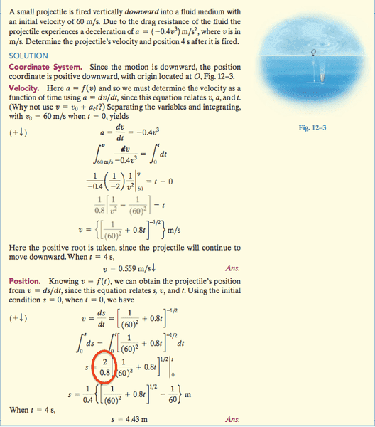

Can someone tell me how to obtain the figure in red circle? I've trying out on my own but can't get that.

You're asking why is ∫ (0.8t + A)-1/2 dt = (2/0.8)(0.8t + A)1/2
apply the https://www.physicsforums.com/library.php?do=view_item&itemid=353" twice
if you differentiate the RHS, you get an extra 0.8 from the t, and an extra 1/2 from the power, = (0.8/2) :wink:

Thanks a lot!:smile: I neglected the 0.8 during the integration. Got it already. Forgotten the basic rule of integration. :frown:
may i know from same question as above shown, how to get the -1/60 at the end there?
the ##|^t_0## at the end of the previous line means you have to evaluate it at t and at 0, and subtract :wink:

oh~okie~thanks! i made mistake that evaluate at 0 whole things became 0~:frown:
