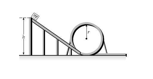

I am working on an assignment and I honeslty am completely baffled with this question. I have no idea how to go about trying to figure it out as its purely conceptual based. If anyone has any info that might help, I am all ears. The problem is as follows and I am attaching the diagram as well if it helps:
A block of mass m slides down an inclined plane into a loop-the-loop of radius r . (a) Neglecting friction, what is the minimum speed the block must have at the highest point of the loop in order to stay in the loop? [Hint: What force must act on the block at the top of the loop to keep the block on a circular path?] (b) At what vertical height on the inclined plane (in terms of the radius of the loop) must the block be released if it is to have the required minimum speed at the top of the loop?

If you had used the homework posting template (please get in the habit of doing that), one of the sections asks what equations and/or priciples apply to your question. What can you tell us about that?
I did not post any formulas because I am not sure what I can use. Like this question doesent use any numbers, you are only supplied with generalizations of certain aspects. Like friction is negligaable. Also since the cart is at a height you can use potential energy formula. But I still can't find a formula that i could use to solve for speed. I know it has to do with centrifugal force but I am just not sure. That is why i am asking.
Well at least you're starting to use some of the right keywords. Show us some equations for the KE and PE of an object, and tell us about the total energe TE. What equations govern circular motion? What equation would you use to figure out the forces on an object that is exhibiting uniform circular motion?
Remember that at the top of the loop mg=m\frac{v^2}{r}
