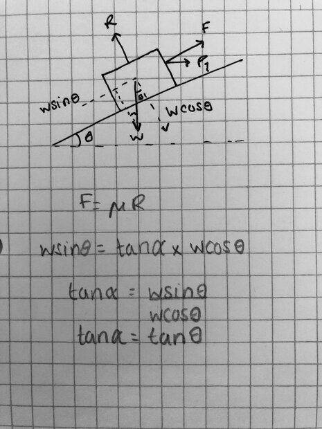

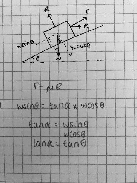

A block rests on a slope which is angled at θ° to the horizontal. The coefficient of friction between the surface of the slope and the block is tan α. P1 is the horizontal force that needs to be applied to the block to stop it from slipping down the slope, whilst P2 is the greatest horizontal force that can be applied without the block slipping up the slope. Show that P2/P1= (tan(θ + α))/(tan(θ - α))
F= μR
The best I could do was draw a forces diagram. I know that friction would be working up when the block is on the point of slipping down the plane and friction will be acting down the slope against the direction of motion when the block is on the point of slipping up the slope. (not even sure if I have that right at this point)
I don’t know how to go about this problem at all.
So post your diagram for that case and see what equations you can write.

does that look right
You need to do this in two parts. First you need to analyse the case where we have force ##P_1## and the block is almost slipping down. Then, when we have the force ##P_2##.
Note that your normal force depends on ##P_1## and ##P_2##.

I don’t understand what would happen to the normal force as it goes from P1 to P2. I thought the only thing that would change is the direction of friction.
It is hard. I didn’t come across any similar problems in practice questions but I think we have covered all the necessary stuff to apply to the question.
What if ##\theta = 90## degrees? What's the normal force then?

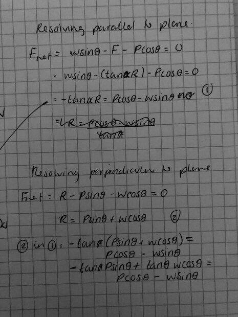

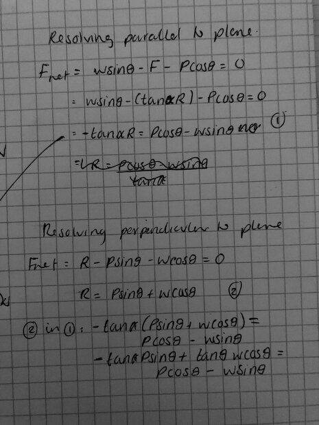

is this right so far
Just a quick side note -- please learn to post math equations using the "LaTeX Guide" link below the Edit window. That makes your work *much* more legible than uploading dark pictures of your hand-written work. Thanks. :smile:
Okay, to give you some Latex to copy and work with we have:
$$R = W\cos \theta + P\sin\theta$$I must admit, the next equation I would have written down is:
$$F = \mu R = \mu(W\cos \theta + P\sin\theta)$$And you have:
$$W\sin \theta - \mu R -P_1 \cos \theta = 0$$Note that at this point the general ##P## becomes ##P_1##.
Now, you need to work on that a bit to isolate and get an expression for ##P_1##.
sorry I had the signs muddled and also wrote tan (theta) instead of alpha.
so I rewrote the equation to get
##Wsin \theta -tan \alpha Wcos \theta -tan \alpha Psin \theta -Pcos \theta## =0
And then rearrange for P:
P= ## \frac {Wsin \theta -tan \alpha Wcos \theta }{tan \alpha sin \theta +cos \theta }##
this would be the equation for P1 and then I’d I write the equation for P2. after that I should be able to simplify P2/P1 to get the equation stated in the question right?
Looks right so far.
