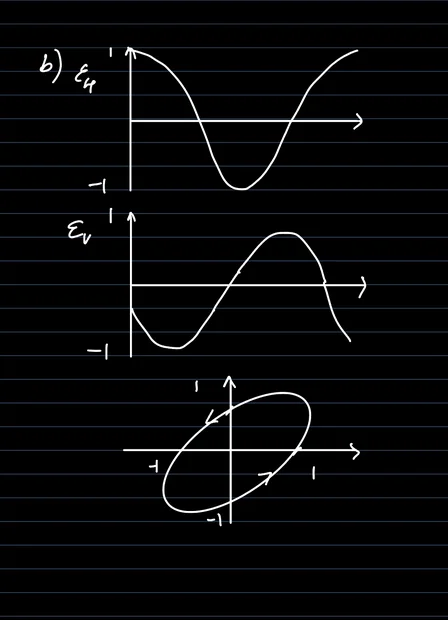

a) Plot, as a function of time, the horizontal and vertical components of
E(0,t) for 0 ≤ ωt ≤ 2π. Plot the trajectory of the point (Ex,Ey) for a constant z as a function of time.
A_H = 1, A_V = 1, ϕ_H = 0, ϕ_V = π/4
b) How would you convert the polarization pattern in part (a) to horizontal using
one half-and one quarter-wave plates? What should be the angles of both plates?
n/a
(a) The polarisation pattern is elliptical with maximum (1,1) and minimum (-1,-1), and anticlockwise in direction.
(b) I know the solution is a quarter-wave plate oriented π/4, and half-wave plate at π/16, but don't understand how to reach there. I've obtained the polarisation vector (cos π/8, isin π/8) so far.
I can't find much online guidance or textbook material working through this topic, so I'd appreciate any help I can get. Also, if anyone could let me know where I can get more practice on these kinds of problems that'd be great!

For part (a) I get an elliptical shape with maximum (1,1) and minimum (-1,-1), and anticlockwise in direction.
Part (b) is asking to convert this to horizontal polarisation using 1/2 and 1/4 wave plates.

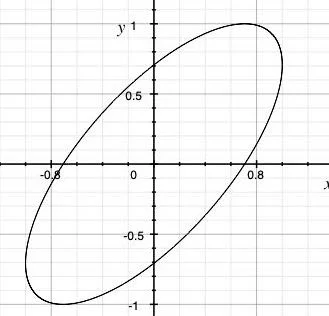

OK, let's backtrack and write some equations. For part (a) you can write $$\mathbf E=\left[\sin\left(t+\frac{\pi}{4}\right),\sin(t)\right].$$ A parametric plot gives the figure on the right which is what you have shown in post #3.
What equations will you get if you line up:
1. The quarter-wave plate with the x-axis?
2. The quarter-wave plate with the y-axis?
3. The half-wave plate with the x-axis?
4. The half-wave plate with the y-axis?
Does any one of these give you a phase difference of ##\pi## or zero which would mean linear polarization?
I
___________________________
@catedral3000, it’s worth addressing some problems with your answers to part a).
From the first graph it appears that you are using cosines. On this basis...
For convenience take ##\omega =1## and ##z=0##, then the question effectively specifies that ##E_H = \cos (t)## and ##E_V = \cos (t + \pi/4)##.
In this case:
- the first graph is correct;
- the second graph is wrong; it is a graph of ##E_V = \cos (t + 3\pi/4)##;
- the direction on the third graph should be clockwise (e.g. find the points on the ellipse corresponding to t=0 and t=[a little bit bigger than 0]).
Also, (1,1) and (-1,-1) are not the ‘maximum’ and ‘minimum’ of this ellipse.
