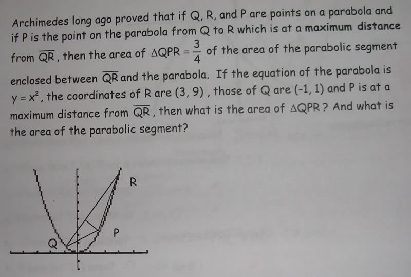

I'm having a tough time solving this question.:frown: I'd appreciate it if someone can please help me out
y=x^2
Triangle QPR =3/4 of the area of the parabolic segment enclosed between QR and the parabola
I don't know where to start :(

Nope, we haven't been taught that. We actually just started with integration today. Anyways, I think I kind of got the first step though -y=x^2
and then the equation of the line b/w Q and R can be found out
m = 9-1/ 3-(-1) = 8/4= 2
y-1=2(x+1)
y=2x+3
elminating y and we get:
x^2 - 2x -3
now what shall I do?

Correct! But it is a definite integral, so
[tex]I=\int_a^b|f(x)-g(x)|\,d\,x=(x^2+3x-\frac{x^3}{3})\Big|_{-1}^{3}[/tex]
:cool:
now how shall I proceed?
Did you find I?
I don't know how to do that. Do I have to plug -1 and 3 into x?
Ok!
[tex](x^2+3x-\frac{x^3}{3})\Big|_{-1}^{3}[/tex] means
[tex](x^2+3x-\frac{x^3}{3})\Big|_{x=3}-(x^2+3x-\frac{x^3}{3})\Big|_{x=-1}[/tex]
So that just becomes
9 -(2 - (-1/3))
9 -(2.33)
6.67 units^2
I think its better [tex]\frac{32}{3}[/tex] :smile:

aah so the area of the parabolic segment = 32/3 units^2
while the area of the Triangle = (3/4)*(32/3) = 96/12 = 8 units^2
Yes! But I think you have to calulate the area of the triangle independently.
Thank you! :smile:
But doesn't it say that "Triangle QPR =3/4 of the area of the parabolic segment enclosed between QR and the parabola"
so that makes the triangle areas 3/4 of 32/3units^2 which is equal to 8..right?
also can you please explain how you got 3 and -1 for the numbers to be plugged in?Thanks

Now how do we go about calculating the area of the triangle?
I don't understand what [tex]\overline{QR}[/tex] stands for. Does it stands for the chord QR?
yes it does
Ok! How can you calculate an area of a triangle if you know the coordinates of the vertices?
but do we don't know the coordinates of point P.
1/2 * 8.944 * height
Yes, but we know the propety that P satisfies.
hmm so how do we go about using the the maximum distance from QR statement?
That's the easy part :smile:
We already now the equation of the line QR. Let the coordinates of P be [tex](x_0,x_0^2)[/tex]. Now what's the distance of P from the line QR?
The distance equation is Ax+By+C/ sqrt (a^2+b^2)
so the distance will be 2(x0) + 1(xo^2) +3 / sqrt(4+1)
You need an absolute value, and I think that
[tex]d=\frac{|2x_0-x_0^2+3|}{\sqrt{5}}[/tex]
Correct?
yes, you're right
Good! :smile:
Now what's the maximum value of [tex]d[/tex]? For which [tex]x_0[/tex] you obtain that?
