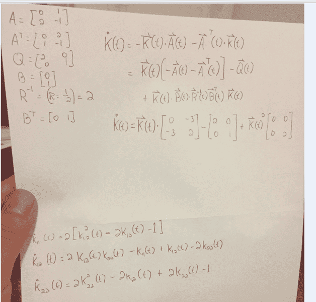

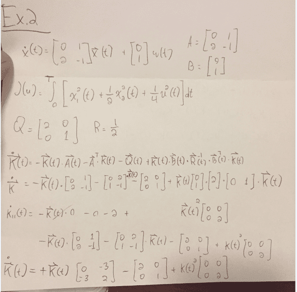

I was wondering if I can get some help on a Linear Regulator Problem for an Optimal Control Problem. Given a state equation and performance measure I am trying to solve using the Riccati equation on MATLAB. This is a sample example I got from a book Optimal Control Donald Kirk. I don't understand how they derived three separate differential equations from the Riccati equation:
The problem goes as followed:
Consider the system https://www.physicsforums.com/attachments/upload_2016-11-26_20-25-28-png.109458/
https://www.physicsforums.com/attachments/upload_2016-11-26_20-26-3-png.109459/
How did they go from a single equation K to three separate equations. I keep looking for resources but many other examples seem to skip this part. Thank for any help or input.
https://www.physicsforums.com/attachments/upload_2016-11-26_20-26-46-png.109460/
[/B]
Handwritten derivation for Example 2: state equation with A and B matrices, cost integral, Q and R weights, then the matrix Riccati equation expanded into component differential equations for the entries of K.
Handwritten working on lined paper: matrices A, Q, B, R and B transpose, then the matrix Riccati equation K-dot = -K A - A^T K + K B R^-1 B^T K, expanded into scalar equations for K11, K12 and K22.

The differential equations for ##\mathbf{K}## and its transpose ##\mathbf{K}^T## are the same; and (as your attachment in post #2 states), ##\mathbf{K}(t_f) = \mathbf{S}##, where ##\mathbf{S}## is a symmetric matrix. Therefore, the solution ##\mathbf{K}(t)## is a symmetric matrix as well. Now just write the Ricatti equation for the symmetric matrix ##\mathbf{K}## in terms of its components:
$$\mathbf{K} = \pmatrix{K_{11}&K_{12}\\K_{12} & K_{22}} $$

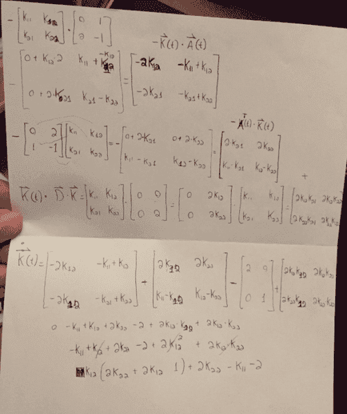

I'm still a little confused. I understand that the matrix is symmetric. I just don't understand how they have it equal on the LHS a row of three 3x1 differential equations when K seems to be a 2x2. That's where I'm confused. I'm thinking this is some linear algebra property that's going over my head. I don't know if the notes I provided actually answer my question. Thanks for the response
Handwritten derivation on paper of a matrix Riccati-type equation for K(t), with 2x2 matrices K, A, B and multiplication and transpose terms, expanded into entries in component form.
I have not checked the picture: it is too messy and unstructured. However, both sides of your differential equation are 2x2 matrices, so you get 4 coupled differential equations. Since the matrix is symmetric, only three of the equations are different
I think I understand now. I was just confused on multiplying the X Matrix by another 2x2 Matrix. I was thinking the equations would combine X11 + X12 as in the case of a 2x2 and 2x1 but it makes sense now. Thanks.
