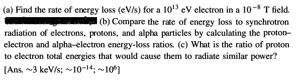

Hello! I'm solving problems which come with their answers... but I get different results! Can you help me, please?
The problem statement and equations are in the attached images.

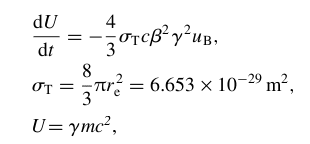

Also:
U=energy in Joules
β=v/c≈1 (relativ. particles)
μ0=4π×10-7
(Image)
uB=B2/(2μ0), B=magnetic field in Teslas
(a) Only substitute the values. I obtain -4.05×10-16 W= -2531 eV/s.
(b) [itex]\frac{(dU/dt)<sub>proton</sub>}{(dU/dt)<sub>electron</sub>}[/itex], only the term γ2proton2electron remains and it is equal to (mc2)2proton/(mc2)2electron=2.96×10-7!
And it yields 1.86×10-8 for α particles. :-s
(c) Like process in (b), but equating instead of dividing. This gives γproelect, and Uprot/Uelect= (mc2)prot/(mc2)elect = 1.84×103...
I have spent several hours in problem solving, now I'm tired and sleepy and can't see where is the mistakes(s), please, help!

If you use the classical electron radius re for electrons, you should substitute this for other particles. This should give two additional factors of ##\frac{m_e}{m_p}##.
Ohhh! You're right! I didn't consider that, only took the given value for σT...:blushing:
Thanks!
Wait... How to obtain m_p from r_p (or viceversa) if don't know density?
I found already values for r_p and r_α, ~10^-16,-15 m, but I would like how to deduce them. Substitute p & α parameters into expression for r_e gives me radius ~10^-37!
Thanks, I have the value of class. e- radius, r_e= 2.818e-15, rather I need right values for radii of proton and alpha particles, because those I found are... odd:
r_p=2.1e-16
r_α=2.1e-15
How can be possible r_p<r_e?!
Another founded value for r_p is 8.6e-16, and r_alpha =4r_p...
I've tried to calculate them from formulae in http://en.wikipedia.org/wiki/Thomson_scattering and http://en.wikipedia.org/wiki/Classical_electron_radius:
http://upload.wikimedia.org/math/f/1/9/f196c5b29b4e0fed8f4710bedc522016.png & http://upload.wikimedia.org/math/5/3/d/53dc80a0e75009917114d545c93fc0a4.png=mc^2 without the factor 1/2, as it is said there... and I got 4.51E-034 for r_e & 8.72E-061 for sigma_T! :'(
I am increasingly confused!:( HEEEEEEELP!
Oh, I have it!, I have it! other factors are eliminated leaving only masses quotint^4!
