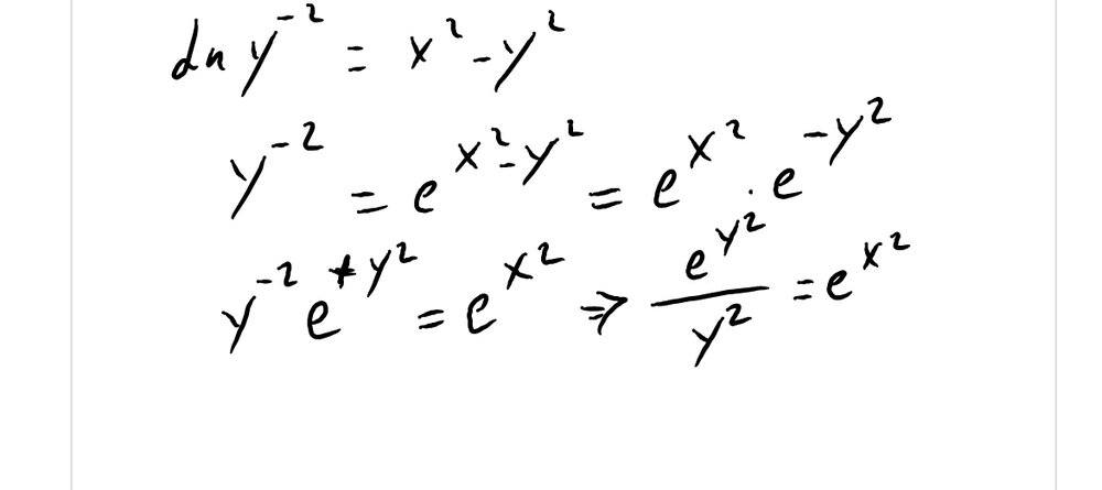

Hello
You can see the picture, but I got stucked, I wanted to find y

It is possible to express ##y## in terms of ##x##. From your calculations you have that
$$y^{-2}e^{y^2} = e^{x^2},$$
this it great. Rearrange the equation to look like
$$-y^2e^{-y^2} = -e^{-x^2}.$$
This is an equation of the form ##we^w = z## and can thus be solved using the Lambert ##W## function <LINK>. Accordingly
$$-y^2 = W_0\big(-e^{-x^2}\big) \qquad\vee\qquad -y^2 = W_{-1}\big(-e^{-x^2}\big),$$
provided that ##\vert x\vert\geq1##. Finally, note that both ##W_{-1}## and ##W_0## are negative valued for ##\vert x\vert\geq1##. Thus
$$ y = \pm\sqrt{-W_{k}\big(-e^{-x^2}\big)},\quad k =-1,0\ \text{and}\ \vert x\vert\geq1.$$

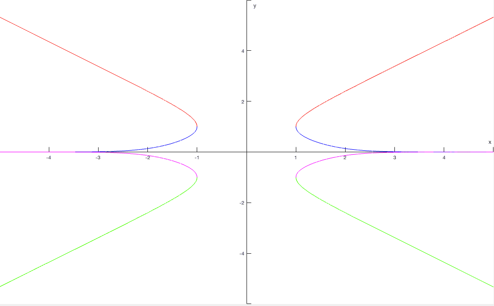

UPDATE
Thought I would include a plot of the solution as well.
The red curve corresponds to the solution ##y = \sqrt{-W_{-1}\big(-e^{-x^2}\big)}##.
The green curve corresponds to the solution ##y = -\sqrt{-W_{-1}\big(-e^{-x^2}\big)}##.
The blue curve corresponds to the solution ##y = \sqrt{-W_{0}\big(-e^{-x^2}\big)}##.
The magenta curve corresponds to the solution ##y = -\sqrt{-W_{0}\big(-e^{-x^2}\big)}##.

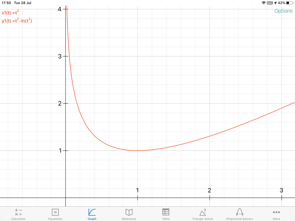

In the present case we could say we have a relationship between two variables we can call ##x^{2}## and ##y^{2}##. ##x^{2}## ≥ 0 but ##y^{2}##≥ 1. To every value of ##x^{2}## corresponds one value of ##y^{2}##, but to every value of ##y^{2}## corresponds two of ##x^{2}##, see fig 1. Simples.

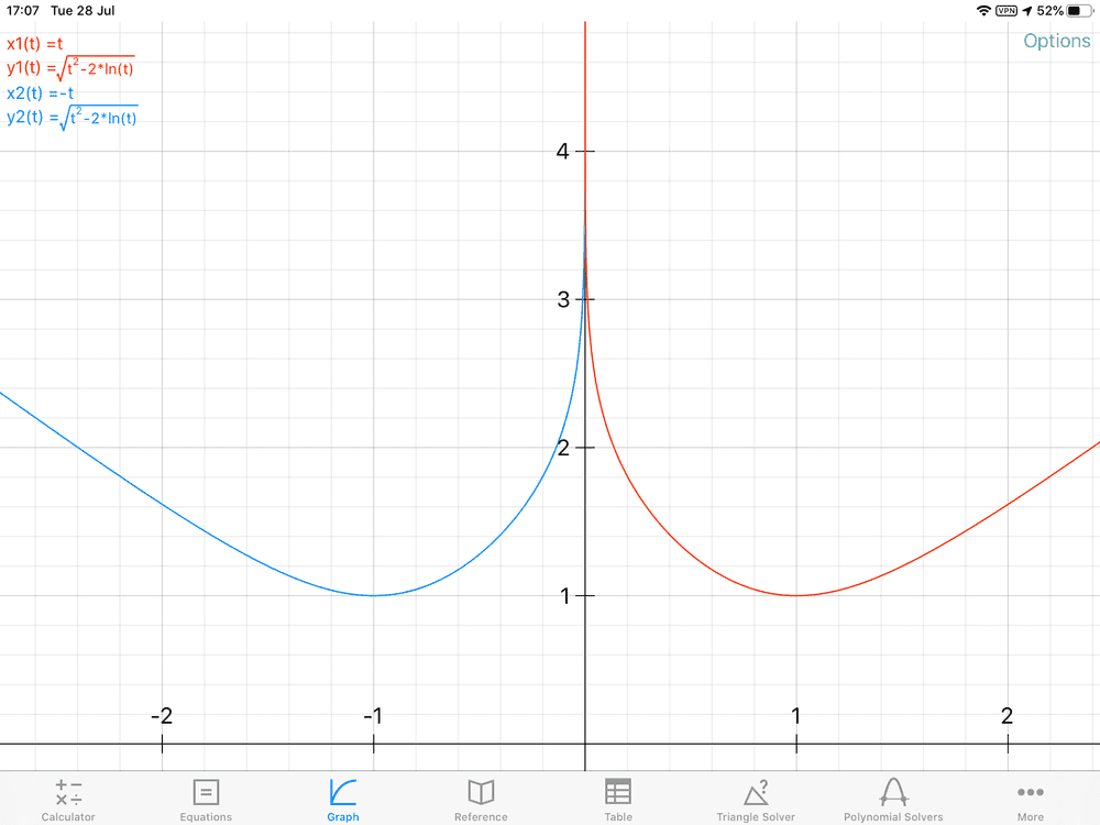

If we want it as function of ##x## itself see fig 2.
So a qualitative answer to the question is that to every y ≥ 1 corresponds four values of x in the form ± x1, ± x2
