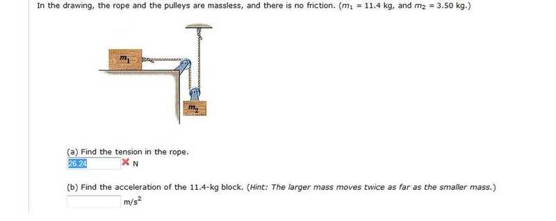

Here is the
Please teach me how to solve this
thanks!

Well i don't have a lot of work to show.. I know
F=ma
The bottom one i believe would be *gravity (9.*8)
i'm just really lost on what equation i need to be using to get the tension in this setup
Start by looking over some of the problems in that link I gave you.
You'll need to draw free body diagrams for each mass, then apply Newton's 2nd law to each.
m2g-t=m2a
t=m1a
but i am missing acceleration and tension so how do i solve when i have 2 unknowns?
you sure tension on m2 till be just T ?
and use the hint of question to find the acceleration of the blocks
drastice said:
m2g-t=m2a
t=m1a
Almost. Fix your first equation using cupid.callin's hint.
Luckily you have two equations.

i'm not sure what you mean by that.. I'm looking at the link he gave me using the horrizontal pulley... Is this not the right equation? i don't see why you guys can't help me with the right equation
and for acceleration m2*gravity/m1+m2 = acceleration right??
That's a different problem. In your problem there's a pulley attached to the falling mass. Get the idea, don't just copy the equation.
We are helping. (But we're not going to do it for you.)
No.
Don't skip steps. Fix your equation for the falling mass. Then you can solve for the acceleration and tension.

I don't expect you to do it for me... All i am asking is for the right equation.. I understand how to get acceleration I'm having trouble with the Tension..
i don't understand when he says "you sure tension on m2 till be just T ?"
How many rope segments pull on mass 2?
there's one pulling from mass1 and one in hte opposite direction from the ceiling..
How do i add this to the equation?
What are all the forces acting on m2? Each rope segment applies its own tension.
it has gravity and tension from both ropes..
I have no idea how to add this to the equation though.

You don't 'add it' to the equation, you use it to come up with a correct equation. The approach is always the same: ΣF = ma.
We've been focusing on the forces on m2 (the ΣF part of the equation), but you are making a second error. You have called the acceleration of each mass 'a', but their accelerations are not the same. (See the hint given in your diagram.)
