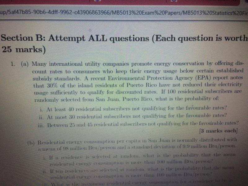

Hi,
Trying to figure this out any ideas as to what I am doing wrong?
Thanks all

You are using the expressions for "exactly 40 occurrences" and "exactly 30 occurrences". So when you did ##1 - P(40)## you've calculated the probability of "anything but 40".
The first question asks for "at least 40". That means 40, or 41, or 42, or ... up to 100. The probability of that would be P(40) + P(41) + P(42) + ... + P(100). Or 1 minus P(0) + P(1) + ... + P(39). Either way, it would be a lot of calculation to add up all those terms. So you're probably expected to use the normal approximation to the binomial distribution.
Does that ring a bell as something you were recently taught in class?
Similarly, part (ii) asks for "at most 30". That means 30, or 29, or 28, or... down to 0. Again, easier with the normal approximation.
