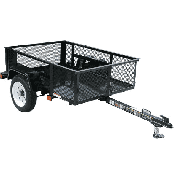

The lights on my trailer are misbehaving. (Actually the electrical powering my trailer is misbehaving)
I've got one of these. It's not even a year old.
The problem is certainly in my tow vehicle (2013 Dodge Journey)'s wiring harness .
The trailer's port tail light is on all the time. The starboard light never comes on.
Neither braking, signaling, nor anything else - including whether the car is on or off - makes any diff.
I guess this started recently, since there was a time when the light worked OK.
The lights on my Dodge work fine, trailer or no.

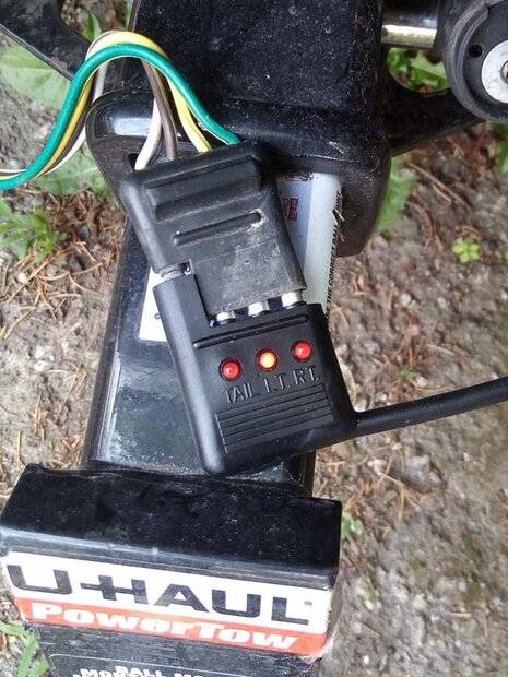

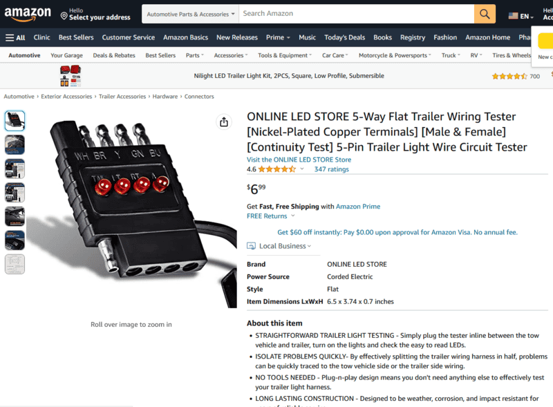

Which electrical connector does it use? You can get little inexpensive in-line LED adapters like this one to help you debug the connections:
https://www.amazon.com/dp/B07G8RJT3T/?tag=pfamazon01-20
I guess I could pick one of those up...
But it's kind of after-the-fact, ain't it? I don't know how it would tell me anything I didn't already know.
(OK, I guess it will tell me if my starboard taillight has power but is blown.)
For me it was helpful in figuring out if the issue was in my trailer wiring or in the cable from my tow vehicle.

4-pin flat. I bought a circuit tester for it (see berkeman's post (but 4 pins) which I will try tonight.

OK, fault confirmed. Left taillight has power all the time. This was tested in the morning without even having my car keys, so it's like this 24/7.
I guess I could test the rest of the states but I'm not sure if there's much point inasmuch as no matter what I have to take the harness in to get it re[paired,placed].
