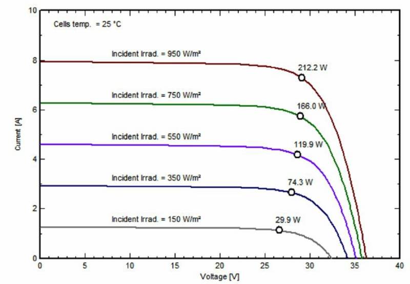

The performance of a solar panel is shown by a current voltage (characteristic) curve, or family of curves. A typical curve randomly picked from the internet is shown below. It is for a much larger solar panel than your solar cell.
For a given amount of light, there is a maximum voltage when the current is zero. There is a maximum current, at which the voltage is zero. You can measure both of these with a multimeter. Measure the open circuit voltage with the meter set to volts, and the short circuit current with the meter set to current. Then you can draw a "good enough" curve freehand using the above figure as a guide.
Then drive the motor with a battery and measure the voltage across the motor. Connect the meter in series with the motor, set it to current, and measure the current through the motor. Compare the voltage and current to the characteristic curve that you just made. Connecting solar cells in series gives you more voltage, but not more current. Connecting solar cells in parallel gives you more current, but not more voltage. You should be able to calculate how many of your solar cells you need to connect in parallel in order to drive your motor.
