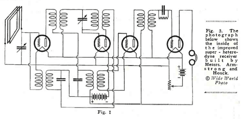

Hi,
I was wondering if any of you fine people can help me understand a few things about Howard Armstrong and Harry Houke's superhet radio receiver built in 1924. My fist question is that they used a second harmonic and I don't understand why. Where was the second harmonic used and how did it help?
In addition, I read a description of their design from a Radio News article from May of 1924 where they have a simplified schematic with 4 triodes and then write that it was great because it only used 6! Where are the missing 2 triodes?
Thank you so much,
Kathy

Lance Wenner said:
This is just a block diagram type to show the converters. It is not the complete schematic which likely has 6 tubes.
well, it's obviously a schematic, NOT a block diagram ( there are no blocks ( labelled boxes
with single lines to the next block/box))it doesn't look too much different to any other radio schematic of that era , eg ...

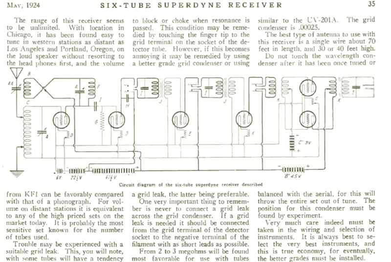

after finally finding the article you were referring to
page 1576 of the magazine
https://www.americanradiohistory.com/Archive-Radio-News/20s/Radio-News-1924-05-R.pdf
I strongly suggest that there has been typo's and that it should have said 4, not 6 for the 2 times mentioned in the text
The article backs up my comments in post #4 that this is the full diagram and not a block diag., as a block diag. is also
presented in the same article !

When using a local oscillator at half the required frequency, the second harmonic is generated in the mixer tube and this is used for the frequency conversion.
The advantages of harmonic mixing are :
1) The LO is at a different frequency to the antenna tuned circuit so it is not pulled by adjustment of the antenna tuned circuit. If it were at the same frequency, when we adjust the antenna tuning it would severely pull the LO frequency.
2) The LO energy, being predominantly at half frequency, is not strongly coupled to the antenna, where it would radiated interference for other receivers in the vicinity.
I should mention that harmonic mixing works very well.
Discussion: The objective with the early sets was to obtain as much gain as possible, hence the low IF, and this exacerbated the problems I have mentioned. When broadcasting commenced, a few years later, a higher IF was chosen, which together with the invention of special mixer tubes, eased these problems and improved the image rejection.
The problem faced by Armstrong at the time was the lack of a tube able to provide stable amplification at high frequencies. This came later with the invention of the pentode, and even later, the grounded grid circuit for a triode. Armstrong had previously invented the regenerative detector, which is very sensitive, but it was tricky to adjust and was pulled around by the antenna. In recent times I have made a "proper" version of the regenerative receiver using mechanically solid construction and with pentode RF amplifier to isolate the antenna. This received is extremely stable and sensitive and is better, I am sure, than the superhet shown above. It is able to detect antenna noise and maybe thermal noise.

Thank you everyone who has replied *so much* for taking the time to help me. I thought that the LO energy was at twice the frequency, but it sounds like the LO was half the frequency making the antenna tuned circuit to be at the second harmonic (that makes so much more sense!). So, to put in some numbers, let's say they wanted to tune to a station at 870 kHz, and the IF was 45 kHz, what signal would they mix? 480 Hz (870/2 + 45) or 457.5 ([870+45]/2) or am I hopelessly confused?

Hi Kathy
The signal is at 870kHz and the required IF is 45kHz. So we require an LO at either 870+45 = 915 or 870-45=825. So the actual oscillator frequency will be half these values, viz 915/2=407.5kHz or 825/2 = 412.5kHz.
The input tuned circuit is not involved in obtaining the second harmonic - the non linear action of the mixer tube will do that. Also notice that the input circuit is tuned to 870kHz which is far away from the oscillator. When small adjustments are made to the input circuit, they do not pull the oscillator..
