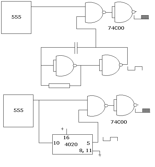

Hey all.
I am using a 555 timer chip to power an IR LED, which switches something on or off. My question is, now my timer chip is sending out 38 kHz IR light. My IR receiver is made to pick up 38 kHz IR light, but only the first 14 (I think) pulses, then ignores all pulses without a pause. Is there any way I could have my TL555 timer chip send out 38 kHz bursts of about 14 waves? Or are there any other ways around this (possibly on the receiving end.)
Thanks,
John
edit: Possibly using just another 555 oscillator at some frequency going to the enable(would that be the reset?) of the other 555 timer chip?
Yes, that's probably the easiest way. There are other ways too, for instance using a counter that counts to 14.
And a 556 will give you both timers in the same IC.
It is probably better to let the 555 oscillate all the time and switch the output with NAND gates.
If you turn a 555 or any oscillator on, it will take a few cycles to stabilize.
Here are a couple of ways of turning a NAND gate on and off to give bursts of output signal.
The first uses a free running oscillator which would give you good flexibility with pulse rate. It should oscillate at about 1 KHz. Any other square wave oscillator (including another 555 ) could be used. I just used some spare gates.
The second uses a counter set to divide by 32. So, the first 16 pulses would produce no output but the next 16 pulses would produce 16 pulses of output from the top NAND gates. So, you would get an exact output which would require no adjusting.
The 74C00 and other chips have 4 NAND gates in one IC. They are very cheap.

A NAND gate works like this:
Both inputs low ...Output high.
Either input low ...Output high
Both inputs high ...Output low.
So if you have 38 KHz pulses getting to one input, they will cause the output to go high and low at a 38 KHz rate only if the other input is high.
The "other" input acts as a control pin and either let's the 38 KHz pulses through or not. This is because, if it is low, it doesn't matter what the other pin is, there is one input low so the output stays high.
If it is "high", the other input will make the output go low if it is high, but remain high if it is low. Try drawing it on a bit of paper, or I will send a diagram of it if you like.
Anyway, the output of the gate will be inverted. (highs will be low and lows will be high). So, the output of the first NAND gate would be high when it is not switching, so I added the second gate to turn the light off.
Notice that the switching rate is still 38 KHz but it is being turned on and off at a 1 KHz rate.
