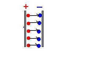

OK i seem to be getting it. But following the same argument can't we conclude that there is no electric field in between the capacitor plates?(since there too the lines terminate at the negative plate). Or is it that the dielectric makes a difference? If so, how exactly? Help will be appreciated..
In case of a capacitor, the field lines are between the plates. The surface charges are on the inner surfaces. The field lines emerge from the positive charges and terminate on the negative ones. No field lines are present inside the metal plates or outside the capacitor.
ehild
